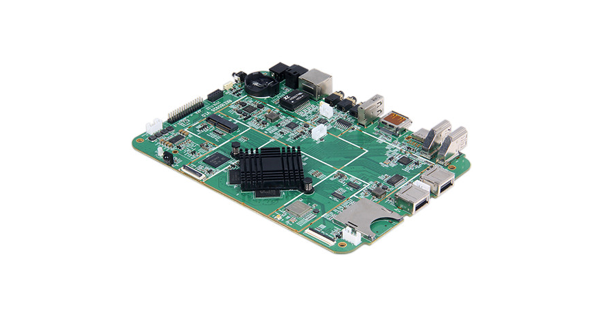

DB3399 SBC
The DB3399 Pro is powered by Android 8.0 and is equipped with 3GB to 6GB LPDDR3 and 8GB to 32GB eMMC. The similar DB3399 board is a lower-spec version of the Pro one. It’s listed with Android 7.1 and offers 2GB to 6GB LPDDR4. The DB3399 defaults to 16GB eMMC, although you can purchase it with 8GB or 32GB. It lacks the Pro model’s RS232 and SATA ports, as well as its GPS, UART, and reset button. There are 5x USB 2.0 interfaces instead of six. A GbE port with Power-over-Ethernet (PoE) is available along with WiFi-ac and Bluetooth 4.2.
Media features include HDMI in and out ports, eDP, and MIPI-DSI interfaces, and a USB Type-C port with DisplayPort support. You also get 2x MIPI-CSI for attaching camera modules, plus SPDIF, a speaker, and several analog audio jacks.
The important features of DB3399/Pro:

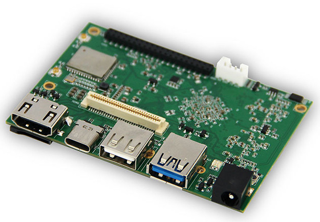

Developer Board 9
DB9 ships with 2GB DDR RAM and 8-32GB eMMC, and offers a microSD slot and a GbE port. The SBC provides 2.4GHz WiFi (802.11 b/g/n) and Bluetooth 4.1, with optional dual-band WiFi-ac. It ships with the standard RK3399 without the NPU. This SBC features an HDMI port, dual audio jacks, a 2.5W speaker, and a camera interface for a 2-5-megapixel camera. It also has a USB 2.0 host and micro-USB OTG ports and a 12V/3A DC input. There also appears to be a 40-pin GPIO connector.
Developer Board 9 SBC

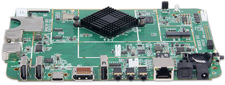

DB3288
The DB3288 is powered by a quad -A17, up to 1.8GHz Rockchip RK3288. This SBC runs much older Android 5.1. The DB3288 has the same 155 x 105mm dimensions of the DB3399 boards. The board ships with 2GB DDR3 RAM and 8-32GB eMMC and offers a microSD slot. The SBC provides 2.4GHz WiFi (802.11 b/g/n) and Bluetooth 4.1, with optional dual-band WiFi-ac.
DB3288 SBC
DB3288 SBC
The DB3288 features HDMI in and 2x HDMI out ports, a DisplayPort, eDP, and MIPI-DSI interfaces, 2x MIPI-CSI, and a separate camera interface. There’s also an audio header, 2x USB 2.0 host ports, and a micro-USB OTG. Other features include I2C, SPI, I2S, RS232, and a 12V/3A input.

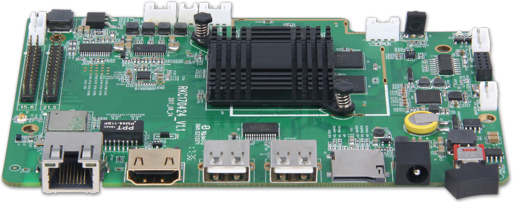

Developer Board 5
Just like the DB3288, the DB5 also runs Android 5.1 on a quad -A17, up to 1.8GHz Rockchip RK3288. The 155 x 105mm board has the same memory, wireless, and Ethernet support as the DB3288. The DB5 is equipped with an HDMI port plus LVDS and DVP interfaces, dual audio jacks, a 2.5W speaker, and an interface for a 2-5-megapixel camera.
Developer Board 5 SBC
