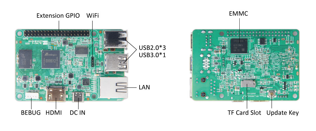

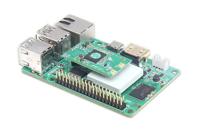

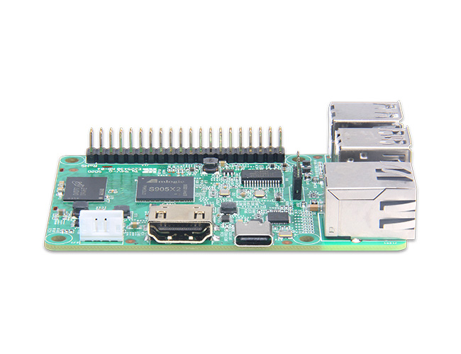

Geniatech’s XPI-S905X2/X3/X4 SBC can be has described as a Raspberry Pi 3 lookalike with features like 2GB RAM, 8GB eMMC, GbE, HDMI, 4x USB, 40-pin GPIO, an optional WiFi/BT, and a 85 mm x 56mm footprint.
Key Features and Specifications of the XPI-S905X2/X3/X4 SBC include:
  • CPU: Amlogic S905X2 (4x Cortex-A53), or S905X3/S905X4 (4x Cortex-A55)
  • GPU: Mali-G31 @ up to 650MHz
  • 2GB RAM (1GB optional)
  • 8GB eMMC (16GB or 32GB optional)
  • MicroSD slot for up to 64GB
  • 1x Gigabit Ethernet port
  • Optional dual-band 802.11b/g with Bluetooth 4.0
  • HDMI 2.0 port
  • USB 3.0 host port
  • 3x USB 2.0 host ports
  • Micro-USB port for power input
  • Serial debug connector
  • 40-pin GPIO header (28x GPIO with support for UART, I2C, SPI, PWM GPIO, etc.)
  • Update key and optional cooling pad
  • 5V power supply via micro-USB; optional adapter
  • Dimensions: 85 mm x 56 mm
