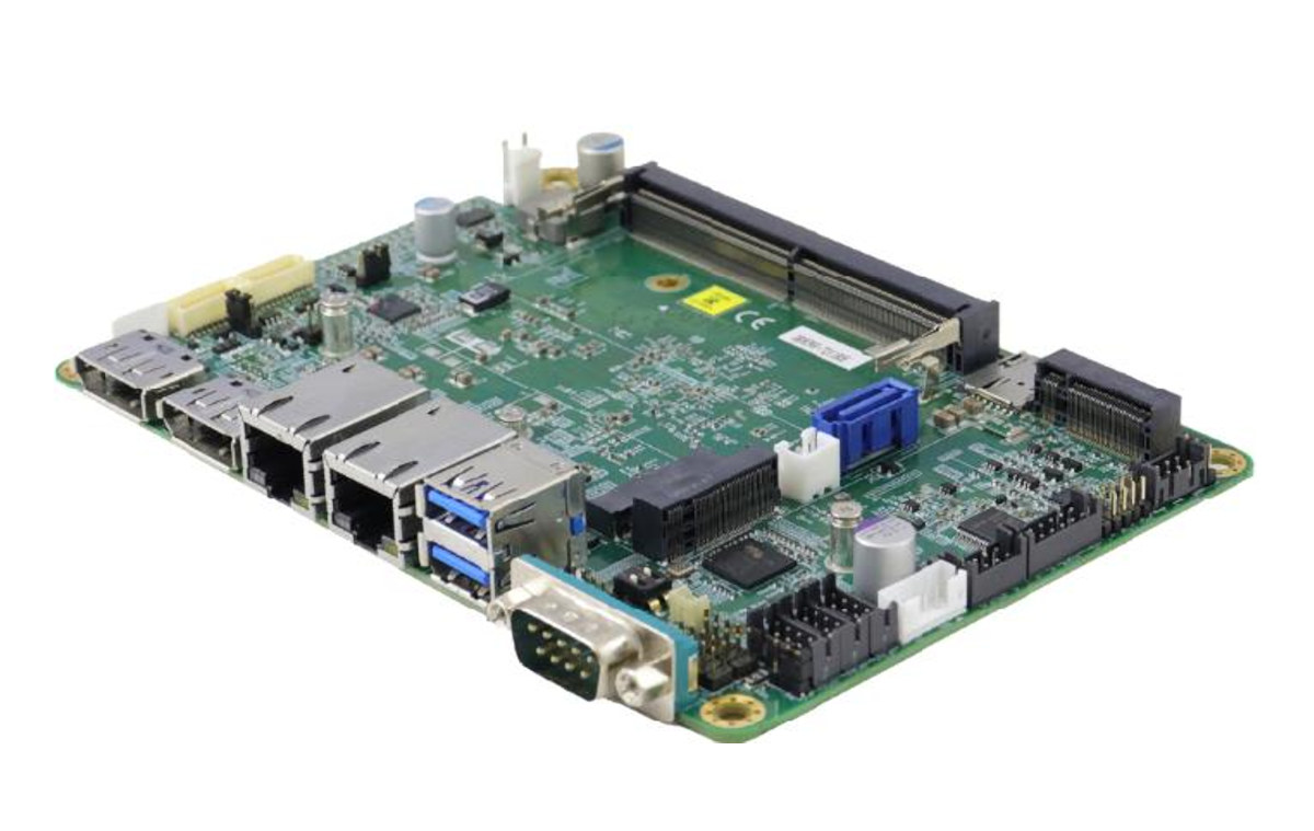

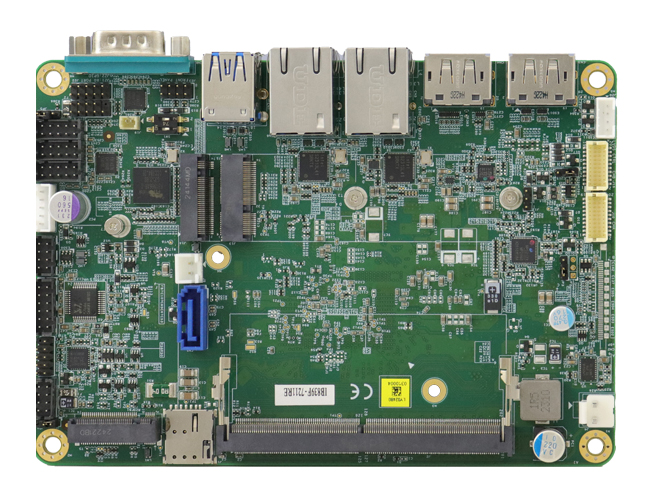

IBASE Technology Inc., a leading provider of industrial motherboards and embedded computing solutions, introduces the IB839, a compact 3.5-inch single board computer (SBC) tailored for modern industrial applications. Featuring onboard Intel® Atom® x7000RE Series or N-Series processors, the IB839 delivers robust performance, advanced connectivity, and wide operating temperature support, making it ideal for edge computing, IoT, and automation systems.
The IB839 supports up to 16GB of DDR5-4800 SO-DIMM memory for fast data processing and multitasking. Display options include dual DisplayPort (DP++) and eDP or LVDS, which are suitable for industrial control panels and digital signage. For connectivity, it offers dual PCI-E 2.5GbE LAN ports (I226IT for Atom x7000RE and I226V for N-Series), 4 COM ports, 2 USB 3.2 (Type-A), 4 USB 2.0, and 1 SATA III interface. Additionally, three M.2 sockets (M-key, E-key, and B-key) support SSDs, WiFi, and WWAN modules for versatile expansion.
IB839 Features:
  • Onboard Intel® Atom® x7000RE Series or N-Series processor
  • 1x DDR5-4800 SO-DIMM, Max. 16GB
  • Supports 2x DisplayPort (DP++) and eDP or LVDS
  • 2x PCI-E 2.5G LAN, 4x COM ports
  • 2x USB 3.2 (Type-A), 4x USB 2.0, 1x SATA III
  • 3x M.2 sockets (M-key, E-key & B-key)
  • +12V~+24V DC wide-range power input
  • Watchdog timer, Digital I/O, dTPM
The 3.5” SBC offers wide voltage DC-in from +12V to +24V, with a watchdog timer, digital I/O, and discrete TPM (dTPM) for enhanced security and reliability. It operates from 0°C to +60°C for N-Series processors and an extended range of -40°C to +85°C for Atom x7000RE CPUs, ensuring stable performance in harsh environments.
The IB839 comes in various models to meet different application needs:
  • IB839F-7433RE and IB839F-7211RE feature Atom processors with dual 2.5GbE LAN and LVDS support.
  • IB839F-N97 supports N97 processors with LVDS.
  • IB839FE-N97 and IB839FE-N97R offer eDP support, with the N97R variant featuring a right-angle PWR connector for flexible deployment.
