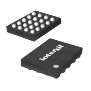

isl91128_applicationISL91128 is available in a small 2.15mm x 1.74mm WLCSP package.

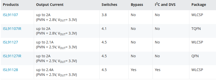

Key Differences in Family
