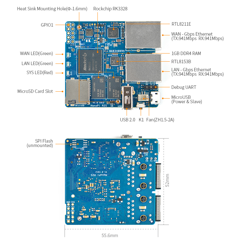

NanoPi R2S Layout
Asides dropping the WiFi and possible memory increases, most of the other features of the new board seem quite similar to the earlier one, although there is a 10-pin I / O in the R2S which cannot be found in the NanoPi R1S board.
