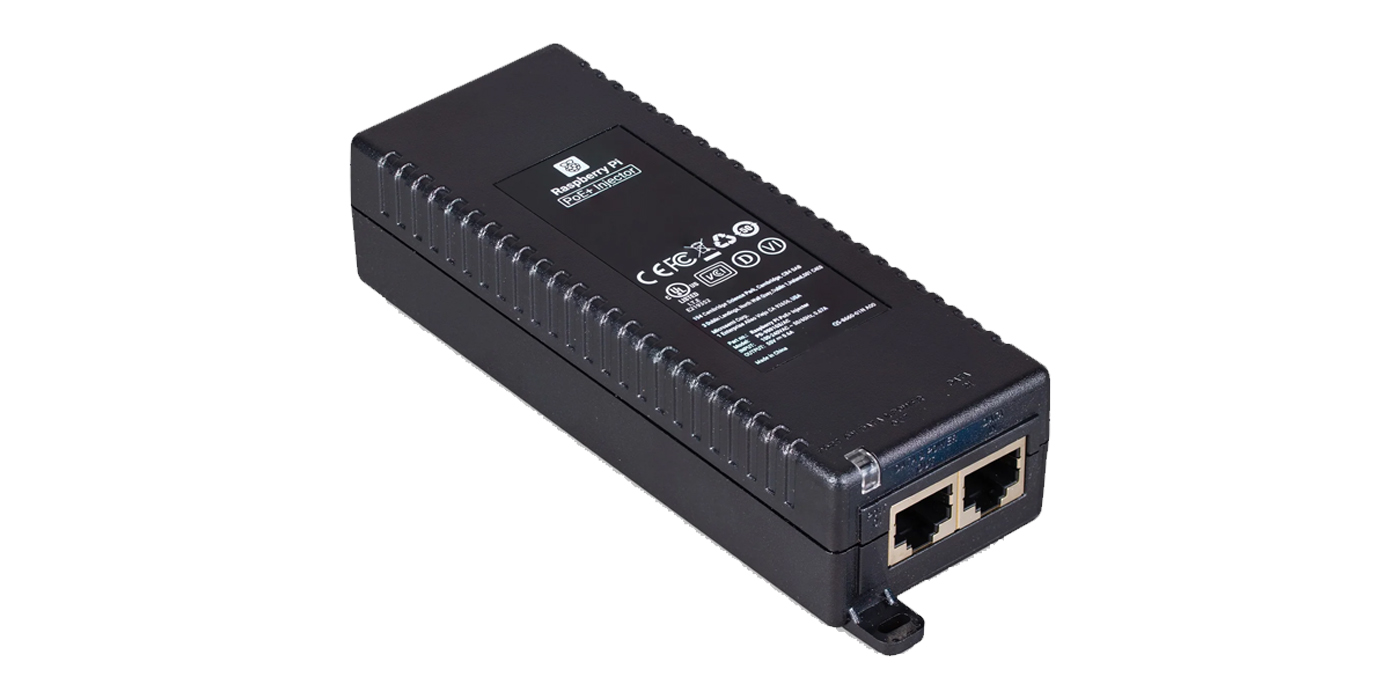

Pimoroni has introduced the Raspberry Pi PoE+ Injector, a compact device designed to add Power-over-Ethernet (PoE) functionality to a single port on a non-PoE Ethernet switch. It delivers both power and data through a single Ethernet cable, offering a cost-effective, plug-and-play solution for integrating PoE into existing Ethernet networks.
The injector supports devices compliant with IEEE 802.3af and 802.3at standards, including all generations of Raspberry Pi PoE HATs. With a data rate of 10/100/1000 Mbps and an output power of 30W at 55V DC, it is ideal for applications requiring reliable power delivery without additional wiring. Key features include shielded RJ-45 connectors, IEC C13 power input (cable not included), and robust build quality with support for a wide range of environmental conditions (–10°C to +50°C operating temperature and up to 90% humidity). Designed to be used in well-ventilated environments, the PoE+ Injector is a practical choice for educational, industrial, or hobbyist Raspberry Pi setups where centralized power management is desired.
The Raspberry Pi PoE+ Injector is rated with a mean time between failures (MTBF) of 200,000 hours at 25° C and is expected to stay in production through at least January 2034.
Raspberry Pi PoE+ Injector + RPi
