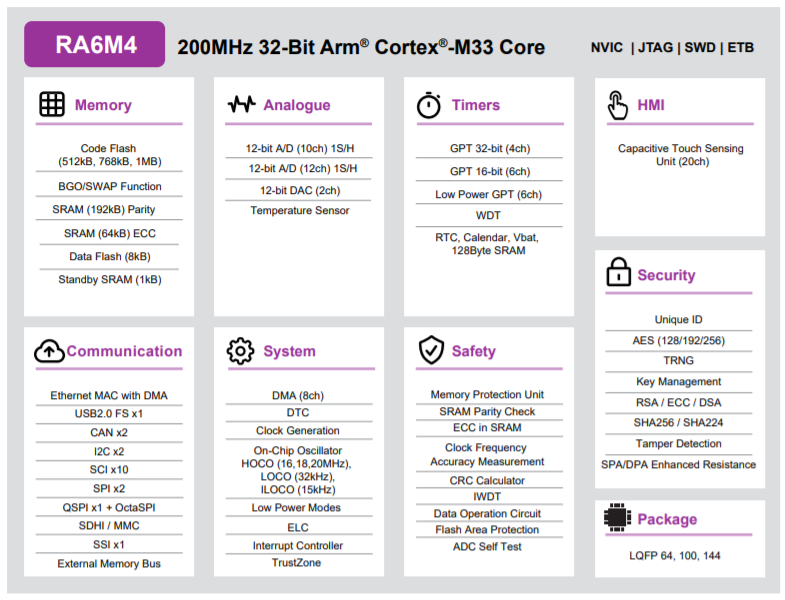

Block diagram for the Renesas' RA6M4 family of MCU's
Block diagram for the Renesas’ RA6M4 family of MCU’s
