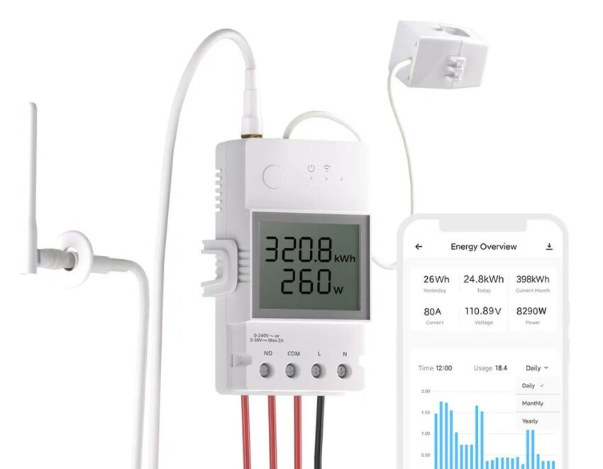

SONOFF POW Ring Smart Power Meter (POWCT) specifications:
  • MCU: Espressif ESP32 dual-core Wi-Fi + Bluetooth microcontroller
  • Wireless connectivity: 2.4GHz Wi-Fi 4 (802.11 b/g/n) with external SMA antenna connector
  • Current transformer (CT) interface: RJ9 port (supports only single-phase power measurement)
  • CT detection range: 0 to 100A
  • Measurement category: CAT II, 0–100A, 300V Max
  • Relay output: Supports 0–240V AC and 0–30V DC up to 2A
  • Display: Integrated LCD screen for real-time power and energy readings
  • User controls: Power/pairing button (single press for power, 5s press for pairing mode)
  • LED indicators: Power (Red), Wi-Fi status (Blue)
  • Power input: 100–240V AC, 50/60Hz
  • Operating temperature: -40°C to +50°C
  • Humidity tolerance: 5% to 95% RH (non-condensing)
  • Enclosure: V-0 rated flame-retardant housing
  • Dimensions: 98 x 54 x 31mm
  • Weight: 120g (excluding accessories)
SONOFF POW Ring Smart Power Meter specificaions

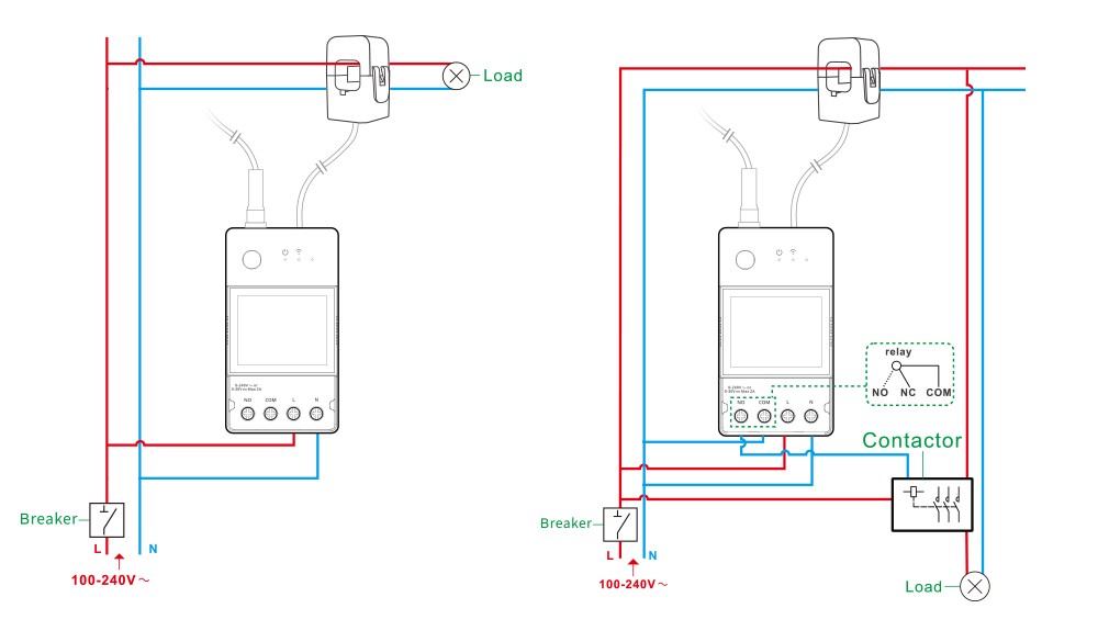

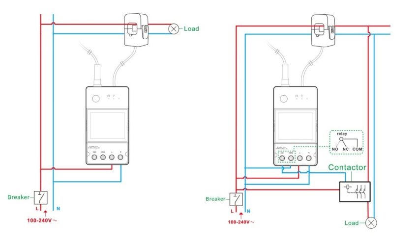

1. Paired with a current transformer to monitor the power consumption of household applianctes.
2. Paired with a current transformer and a contactor to monitor the power con-sumption of household appliances and can also control the power switch.
