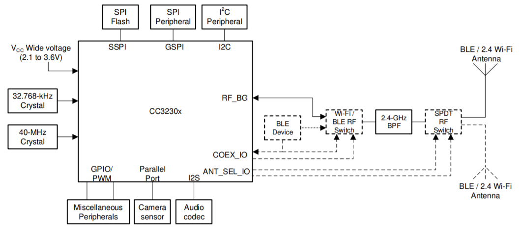

Functional blocks of the CC3230x
As you can see, it is quite packed in features and allows you to develop a lot of interesting IoT applications, specially if secure connectivity and energy savings are what you are looking for. Typical projects that fit into this category are building and home automation ideas, such as HVAC systems, thermostats, video surveillance, doorbells and cameras on areas of difficult access, building security systems, smoke and water leak detectors. Other areas of interest are asset tracking, factory automation and healthcare / medical industries. Lastly, its pricing starts at $8.08, which is very competitive, if you consider the set of features it provides.
