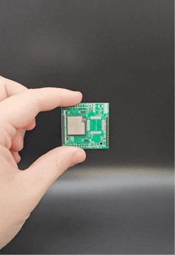

WAN-4-ALL is an IoT module built around the ESP32 microcontroller, optimized for LoRaWAN applications. It is compatible with popular hardware ecosystems, including Arduino MKR, Mikroe mikroBUS, Adafruit Feather Wings, and Seeed Studio Grove shields. The module leverages LoRaWAN technology, licensed from the LoRa Alliance, to enable efficient wireless communication.
Pre-installed IoT firmware and no-code development tools make WAN-4-ALL ready to use out of the box. The module’s pre-flashed firmware enables seamless operation once connected to a carrier board and powered on. Developers can upload applications directly using Lucid, a no-code IDE that eliminates the need for flashing tools, SDKs, or large code repositories.
Designed with multiple communication protocols and peripheral interfaces, the WAN-4-ALL module provides a cost-effective solution for integrating IoT functionality into custom smart devices. Its low-cost production focus and versatile compatibility make it a practical choice for rapid prototyping and commercial product development.

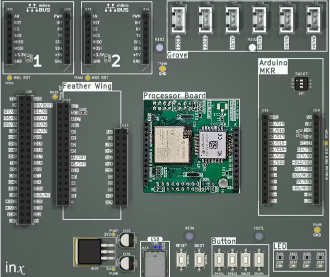

WAN-4-ALL LoRaWAN IoT Module specifications:
  • SoC: Seeed Studio Wio-E5 STM32WLE5JC
    • CPU: 32-bit ARM Cortex-M4 @ 48 MHz
  • Microcontroller: Espressif ESP32-S3
    • CPU: Dual-core Xtensa LX7 @ 240 MHz
    • Memory: 512 KB internal SRAM
    • Storage: 8 MB SPI Flash
  • Networking:
    • 2.4 GHz Wi-Fi (802.11 b/g/n)
    • Bluetooth 5.0 LE
  • Expansion and I/O:
    • 48 GPIO general header pins
    • 4x GPIO buttons (reflashing support)
    • 1x Arduino MKR connector
    • 1x Adafruit Feather Wing connector
    • 2x MikroBUS sockets
    • 6x Grove ports (2x ADC, 2x I2C, 2x GPIO)
    • 3x UART
    • 1x 12-bit ADC
    • 1x I2C
    • 1x SPI
  • Miscellaneous:
    • Real-time clock
    • Board temperature sensor
    • RESET and BOOT buttons
    • 4x GPIO LEDs
    • USB for power, image flashing, and no-code debugger
  • Power Supply:
    • 3.3V and 5V power converters for USB and screw terminals
  • Operating Temperature: -40°C to 85°C
  • Dimensions: 12 mm x 12 mm x 2.5 mm
The ALL-4-WAN Break Out / Carrier board for PoC development
