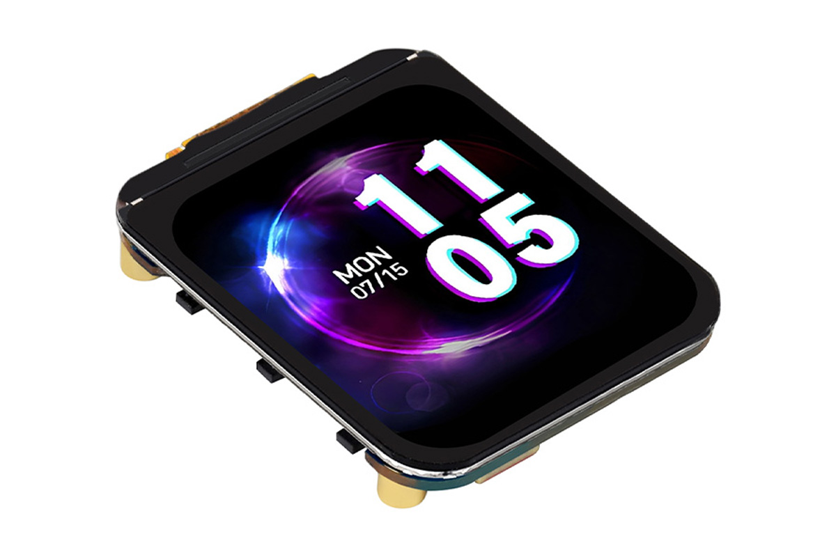

Waveshare has recently launched ESP32-C6-LCD-1.69, a 1.69-inch AI development board with a 240×280 IPS color display, built around the ESP32-C6 SoC with Wi-Fi 6, Bluetooth 5, and IEEE 802.15.4 support. The board is ideal for smart IoT applications, including AI voice interaction, wearable devices, and compact control interfaces.

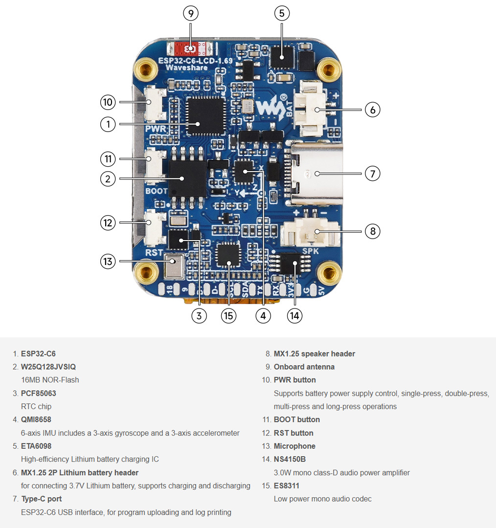

The board comes with 16MB Flash, a 6-axis IMU (QMI8658), RTC (PCF85063), microphone, speaker, and an ES8311 audio codec. Display control is handled by an ST7789V2 via SPI. The board also includes a USB Type-C port, lithium battery management (charging/discharging), RST/BOOT/user buttons, and reserved pads for GPIO, I2C, USB, and UART expansion. Its AI speech capability enables compatibility with platforms like DeepSeek or Doubao.
ESP32-C6-LCD-1.69 AI development board specifications
  • SoC: ESP32-C6 with:
    • 32-bit RISC-V core @ up to 160 MHz (main), 20 MHz (low-power)
    • Wi-Fi 6, Bluetooth 5 (LE), IEEE 802.15.4 (Zigbee/Thread)
  • Memory: 320 KB ROM, 512 KB HP SRAM, 16 KB LP SRAM, 16MB NOR Flash
  • Display: 1.69-inch IPS LCD, 240×280 pixels, 262K colors, ST7789V2 via SPI
  • Audio:
    • ES8311 low-power mono codec
    • NS4150B 3W Class-D speaker amp
    • Onboard microphone
  • Motion Sensor: QMI8658 6-axis IMU (3-axis gyro + 3-axis accelerometer)
  • RTC: PCF85063 Real-Time Clock
  • Battery: MX1.25 header for 3.7V Li-ion battery, with ETA6098 charger
  • Connectivity: USB Type-C (program/debug), onboard antenna
  • Buttons: BOOT, RST, PWR (multi-function), programmable user button

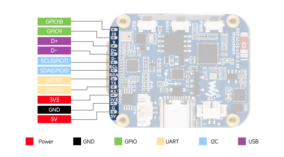

  • Expansion: Reserved pads for GPIO, I2C, UART, USB
  • Dimensions: 30 mm x 37.12 mm
