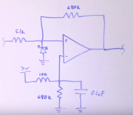

The first basic idea in the design is to use transimpedance amplifier which is basically a current-to-voltage converter.
When photons strike the photo diode, it will actually emit charge carriers, so the output of this sensor is a current. The output voltage (Vout= Ip*Rf) is linear in respect to the current.
IRis_cir1
The major problem with this particular configuration is the unwanted high frequency oscillation, so a capacitor was added in parallel with the feedback resistor.
IRis_cir2
The next problem solved by Craig, is the saturation of the amplifier in high and low side by adding some bias resistors just to keep the reference voltage of the positive input of the op-amp at just under 200 millivolts.
To prevent saturation in high side he added three diodes, in fact three JFETs configured as diode, in the feedback path. The reason of using JFET configured as a diode is that it has less leakage current than normal silicon diodes, so when the voltage exceeds 3*0.7=2.1V then they short the feedback resistor, this point is important in our design because it has a current flow from photo diode.
The last thing to solve in first stage of the design is the problem of constant current from ambient light, which will generate a DC component in the output. So Craig added a high pass filter in the output.
IRis_cir3
Now the circuit will still have some analog signals in output, noise and some negative spikes. So he cleaned things up by using a comparator with a Schottky diode in the non-inverting input to omit the negative pulses less than 0.2 Volt.
IRis_cir4
