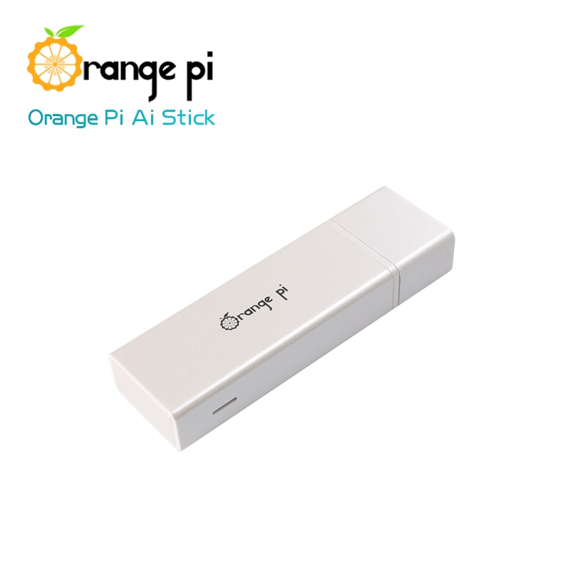

We are entering into the era of AI inference at the edge for low power consumptio. The need for developing AI-powered applications for IoT devices and similar is growing without necessarily sacrificing power or cost. Orange Pi which has been widely known for its Raspberry Pi replication boards has recently launched the Orange Pi AI Stick 2801 which is based on the Lightspeeur 2801S ASIC processor.
The built-in Lightspeeur® optical spear SPR2801AI chip allows Orange Pi AI stick to run machine learning and real-time deep learning directly on the device and just like the Intel Stick, the Orange Pi stick is geared towards image, video, voice, and natural language recognition.
Specifications for the Orange Pi AI Stick:
  • ASIC – Lightspeeur® optical spear SPR2801 AI processor with a 2-dimensional Matrix Processing Engine (MPE) with
  • Performance – AI Processing in Memory (APiM) delivering up to 2.8TOPS @ 300mW, 5.6 TOPS @ 100 MHz (peak performance)
  • Storage – eMMC flash with 68 MB/s read, 84.69 MB/s write
  • Host interface – USB 3.0 Type-A
  • Consumption – 5V @ 300mA
  • Temperature Range – working: 0 to 40°C; storage: -20 to 80°C
  • Dimensions – 66.5 mm x 20.5 mm x 10.8 mm

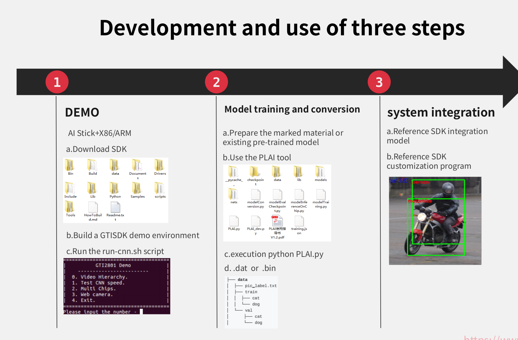

An SDK and user manual has been released for the Orange Pi AI Stick for x86 PC and pre-trained models with some sample cat/dog data. Planning on training your own model and data, you will get set back by an additional $149 for the PLAI model transformation and training tools. The Orange PI AI stick costs $69 alone and can be purchased from Aliexpress. The Stick plus PLAI tools costs $218 and also available for purchase on Aliexpress. PLAI stands for People Learning Artificial Intelligence and is an ecosystem of hardware and tools provided directly by Gyrfalcon, the ASIC vendor.
