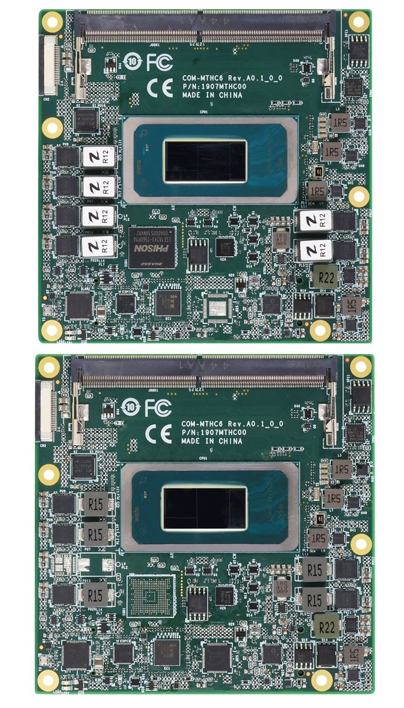

COM-MTHC6 for 45W CPU with BGA SSD option (top) vs COM-MTHC6 for 28W CPU without onboard SSD (bottom)
The PCB of the COM-MTHC6 design remains consistent across all variants, but the 28W model lacks one of the inductor/PMIC units found in the 45W version. The image also highlights the module both with and without a PHISON BGA SSD installed.

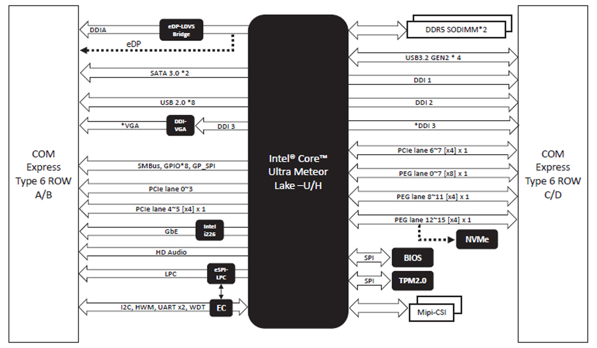

COM-MTHC6 Block diagram
