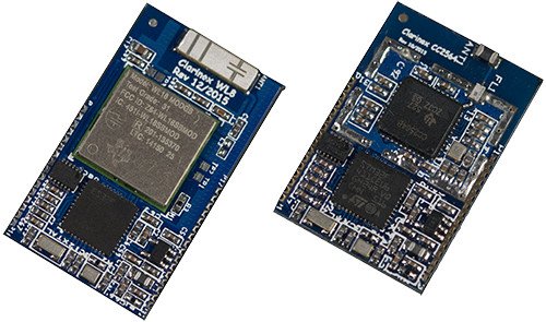

Koala® Connect Modules
KM-141201 (20 x 30mm BT/BLE)
KM-153101 (20 x 34mm Wi-Fi+BT/BLE)

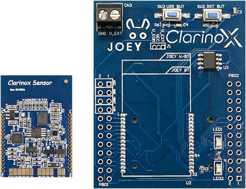

Carrier Board for Koala® Connect
KC-018102
Sensor Modules
KM-990501 Sensor Board

And these are the specifications
Hardware Specifications
MCU: STM32F411 (Bluetooth/BLE), STM32F412 (Wi-Fi + Bluetooth/BLE)
Wi-Fi Radio: TI WL1831MOD / WL1837MOD
  • 802.11 a/b/g/n
  • 2.4 GHz & 5 GHz
  • -96.3dBm RX Sensitivity
  • STA, AP & Wi-Fi Direct Modes
Bluetooth / Bluetooth LE Radio: TI WL1831MOD / WL1837MOD
  • Dual-mode Bluetooth & Bluetooth Low Energy
  • Bluetooth v4.1 Compliance and CSA2 Support
  • Host Controller Interface (HCI) Transport for Bluetooth Over UART
I/O Signals: ADC, GPIO, I2C, I2S, SPI, UART, USB
Industrial Temperature Grade: -40°C to +85°C
