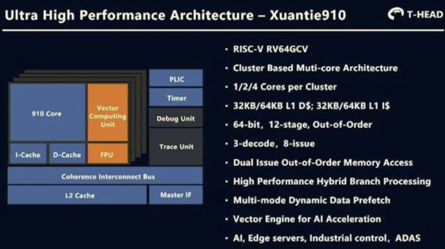

Alibaba claims the XT910 (XT stands for Xuantie, which is a heavy sword made using dark iron), is the most powerful RISC-V processor to date. The performance of the XT910 was compared to Cortex-A73 (Kirin 970) with the same L1 cache capacity, and the results showed that Alibaba chip outdistanced the Cortex-A73 in a number of the benchmark parameters. We are however not sure if the benchmarks included the RISC-V Turbo extension.
Some features and specifications of the XT910 processor include:
  • 16x 64-bit RISC-V (RV64GCV) cores with a peak clock speed of 2.0GHz and 2.5GHz etched in 12 nm processes which include 16-bit instructions.
  • Supports RISC-V 0.7.1 Vector extension and custom Turbo extension
  • Up to Four clusters of four cores
  • 32KB or 64KB instruction/data cache per core and up to 8MB L2 cache per cluster
  • Vector Computing Unit for AI acceleration
  • Sv39 MMU + 8/16 PMP
  • Clint + PLIC interrupt controller, and,
  • Support for unaligned memory data access

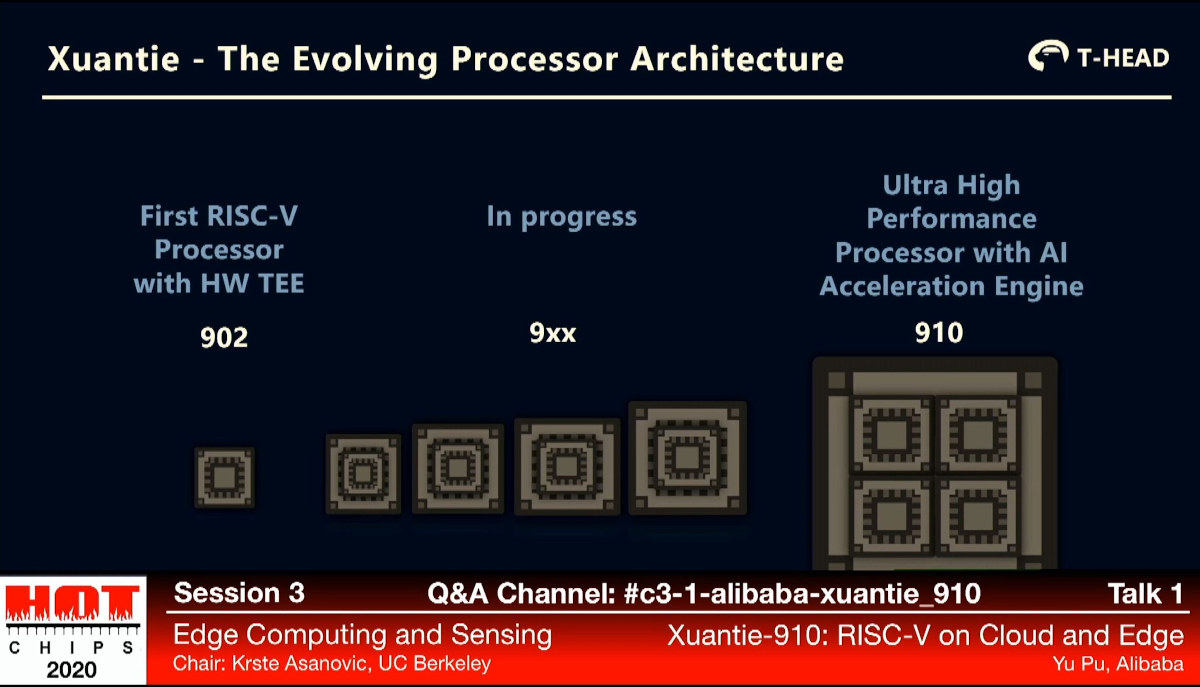

The company also revealed that the XT910 is the first in the line of what they plan to roll out as they have added a low power XT902 microcontroller core (Cortex-M0+ class) with hardware TEE to the league. Plans for others  – including the XT903, XT905, XT907, and XT908 – that will come with different embedded performance and power levels, are also on top gear.
