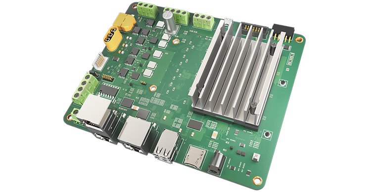

Kria KD240 Drives Starter Kit
The KD240 drives starter kit is designed to help developers and engineers get started quickly with the Kria K24 oOM. It includes the necessary tools and resources to create production-ready solutions for motor control and DSP applications.
The combination of Kria K24 SoM and the development platform is designed to accelerate the time it takes for these applications to reach the market. This is important because getting a product to market quickly can be a significant competitive advantage.
The company emphasizes that users can start using these tools without needing expertise in FPGA programming. This becomes important because FPGA programming can be complex and require specialized skills.
