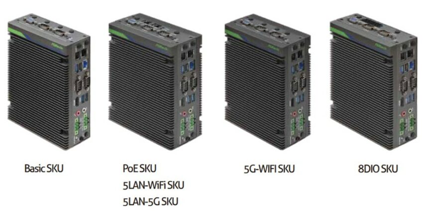

ASRock has introduced the iEP-7040E series, a lineup of fanless industrial IoT controllers powered by Intel’s 15th Gen Core Ultra 200H processors. These controllers feature up to 16 cores (6P+8E+2LPE), 16 threads, Intel Arc Graphics, and an integrated NPU, delivering advanced AI capabilities, high-performance graphics, and robust connectivity for next-generation edge computing.
Designed for seamless industrial integration, the iEP-7040E series offers high-speed connectivity with support for 4G LTE, 5G (available in 5LAN-5G and 5G-WIFI SKUs), Wi-Fi 7/6E (available in Basic, PoE, 5LAN-WIFI, 5G-WIFI, and 8DIO SKUs), and Bluetooth 5.4 RF options.
The ASRock iEP-7040E series combines AI-optimized CPU, GPU, and NPU technologies, making it ideal for intelligent automation, computer vision, and real-time industrial applications. Depending on the variant, it supports either 4x DI/4x DO or 8x DI/8x DO with 36V isolation, up to 96GB DDR5 5600MHz with In-Band ECC (IBECC), and Intel In-Band Manageability with TPM 2.0 for enhanced security and reliability.
ASRock iEP-7040E Industrial IoT controller 1

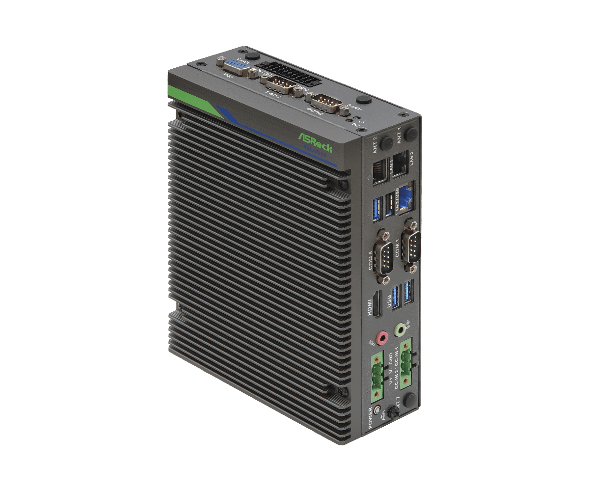

ASRock iEP-7040E specifications:
  • SoC: Intel Core Ultra 7 255H
    • CPU: 2P+8E+2LPE / 12 threads with 2.0 (P) + 1.5 (E) GHz base frequency, 5.1 GHz turbo frequency
    • Cache: 24MB cache
    • GPU: 128 EUs Intel Arc 140T GPU
    • AI accelerator: Intel AI Boost NPU
    • TDP: 28W, up to 115 W (PL2)
  • Memory: Up to 96GB via dual channel DDR5-5600 MHz 262-pin SO-DIMM slots (In-Band ECC support)
  • Storage: 1x Micro SD card slot (Support SD specification v3.0 UHS-I: SDR25/SDR50)
  • Video Output:
    • 1x HDMI 2.0b
    • 1x VGA
  • Audio: 1x Line Out, 1x Mic In

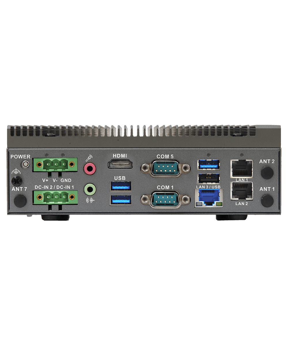

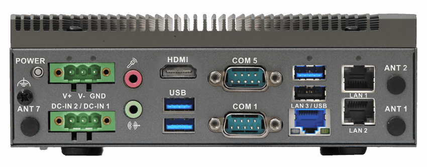

  • Networking:
    • 3x 2.5GbE RJ45 LAN ports via Intel I226-IT controllers with 10/100/1000/2500 Mbps
    • 2x 2.5GbE RJ45 LAN ports via Intel I210-AT controllers with 10/100/1000 Mbps (For 5LAN SKU)
    • 2x 2.5GbE RJ45 ports via Intel I210-AT controllers (PoE SKU only, IEEE 802.3af, 15.4W/port max output)
    • Antenna:
      • 7x SMA connector hole reserved, support for (Basic/5G SKU)
      • 5x SMA connector hole reserved, support for (PoE/5LAN/8DIO SKU)
  • USB:
    • 3x USB 3.2 Gen2 x1 ports
    • 1x USB 2.0 port
  • Serial: 3x RS232/422/485 COM ports
  • Expansion:
    • 1x M.2 3042/3052 B-Key socket and Nano SIM card slot for 4G LTE/5G module (PCIe Gen3x1/USB3.2 mode)
    • 1x M.2 2230/2260 E-Key socket for Wi-Fi/Bluetooth module (CNVi/PCIe Gen3x1/USB2.0 mode)
    • 1x M.2 2280 Key M socket (PCIe Gen4 x4) for storage
    • 4DIs/4DOs (9-pin D-sub) on all SKUs
    • 8DIs/8DOs with 36V sink/source isolation (8DIO SKU)
  • Security: TPM 2.0
  • Manageability: WDT, Intel In-Band Manageability
  • Misc:
    • Power Button with LED / Watchdog Timer
    • 6x LEDs for storage, diagnostics (2x), DC-in (2x), and UD (user-defined)
  • Power:
    • Basic/5LAN/5G/8DIO SKU: 9-36V DC input (2x 3-pin Phoenix connectors)
    • PoE SKU: 19-36V DC input (2x 3-pin Phoenix connectors)
    • OVP, UVP, OCP, 80V surge protection
  • Dimensions:
    • Basic/8DIO SKU: 170 x 134 x 55 mm
    • PoE/5LAN/5G SKU: 170 x 134 x 68 mm
  • Temperature range:
    • Operating Temp.: -25°C to 50°C (w/ airflow 0.5-0.8m/s)
    • Storage Temp.: -40°C to 85°C
  • Humidity: ~95% @ 40°C (non-condensing)
  • Vibration Resistance: 5 Grams, 5-500 Hz, 3 axes (SSD)
  • Shock Resistance: 100G (half sine 11ms with SSD)
  • ESD: Contact +/-8 KV, Air +/-15 KV
  • EMC: CE, FCC Class A (EN61000-6-4/-2)
  • Safety: LVD (Low Voltage Directive (LVD) 2006/95/E)
  • Mounting Options
    • Basic/8DIO SKU: Wall mount, VESA mount, DIN-Rail
    • PoE/5LAN/5G SKU: Wall mount, Din Rail
