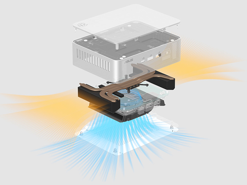

The ASUS NUC 15 Pro+ is a high-performance, AI-optimized mini PC powered by the Intel Core Ultra 9 285H processor with integrated Intel Arc 140T Graphics. It features ultra-quiet cooling, designed for professionals and enthusiasts, ensuring optimal airflow with reduced noise. Intel Wi-Fi 7, Bluetooth 5.4, and 2.5G Ethernet deliver elite connectivity for seamless data transfers. The compact 0.7L chassis offers a sleek design with easy tool-free upgrades.

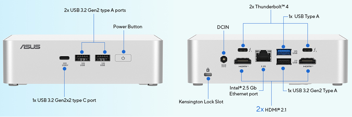

This mini PC features a front I/O panel with one USB 3.2 Gen2x2 Type-C and two USB 3.2 Gen2 Type-A ports. The rear panel includes one USB 3.2 Gen2 Type-A, one USB 2.0 Type-A, an RJ45 LAN port, and a DC-in connector. Measuring 144mm x 112mm x 42mm and weighing 600g, it comes with a 150W power adapter, VESA mount, and documentation. The company highlights its advanced thermal design, which reduces noise levels by 1.2 times for quieter operation.

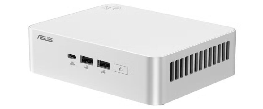

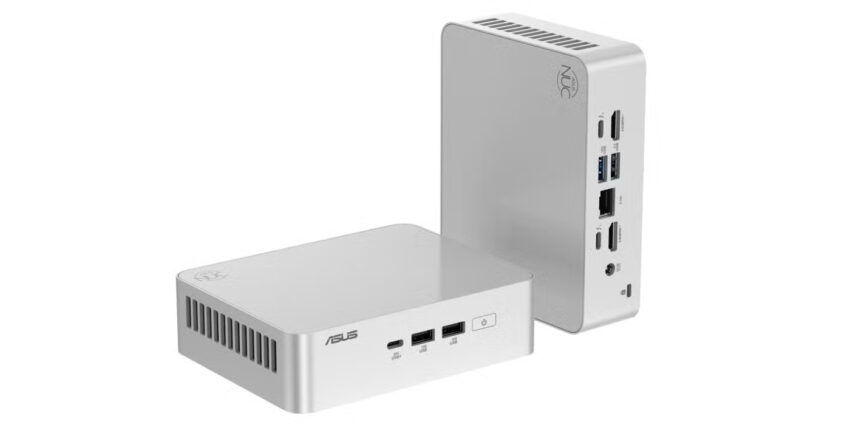

ASUS NUC 15 Pro+ Front and Rare View
