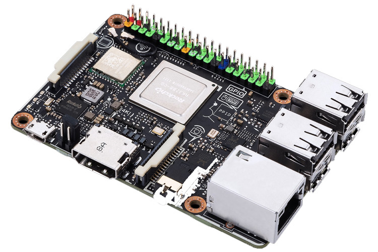

Asus recently announced its second-generation Tinkerboard, the Tinker Board R2.0. Powered by a quad-core Rockchip RK3288 processor, this single-board computer (SBC) features a Gigabit Ethernet port, dual display ports, and additional camera support.
Asus recently announced its second-generation Tinkerboard, the Tinker Board R2.0. Powered by a quad-core Rockchip RK3288 processor, this single-board computer (SBC) features a Gigabit Ethernet port, dual display ports, and additional camera support. With its credit card-sized form factor, it serves as a Raspberry Pi alternative, offering 2x the processing power.

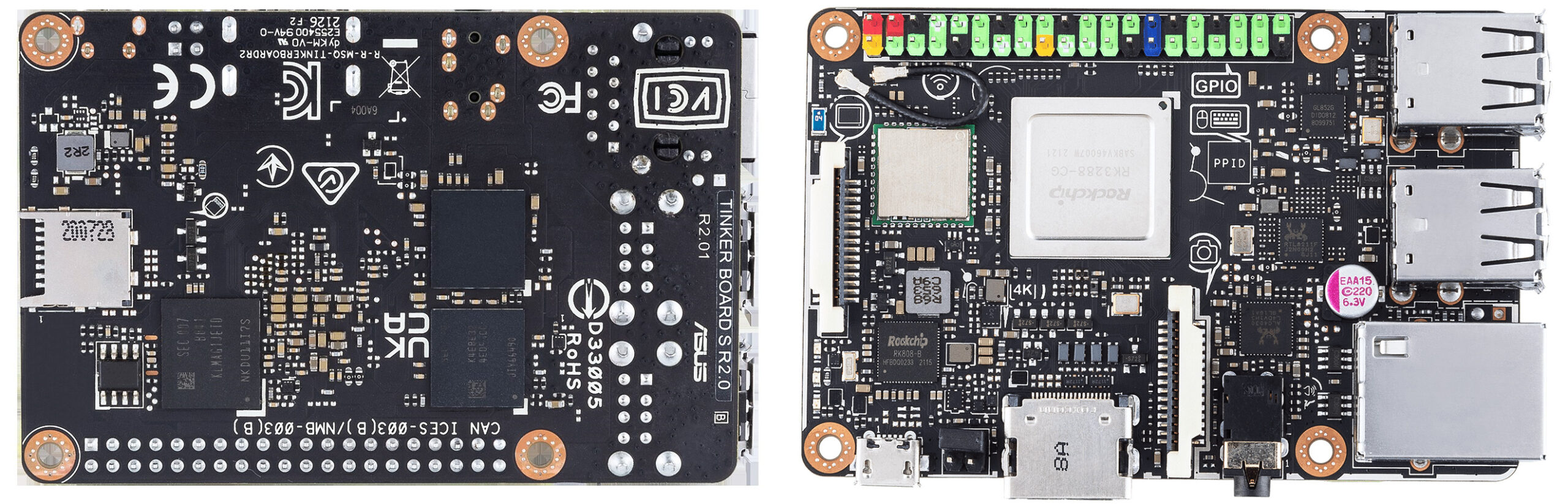

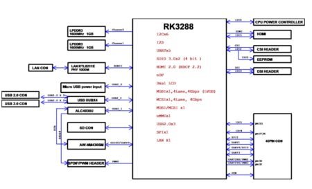

The Rockchip RK3288 is built with a 1.6GHz Quad-core Cortex-A17 CPU with a 600MHz Arm Mali-T764 MP4 GPU. Additionally, the board has 2GB DDR3 RAM, a 3.5mm audio jack, a Wi-Fi & Bluetooth V4 module, an HDMI 2.0 Interface, a MIPI DSI video interface, and a 40-pin color-coded header compatible with Raspberry Pi.
The board supports 4K@30 Hz via the onboard HDMI port. The HDMI also supports audio, which makes this board suitable for media center applications. Speaking about audio, this board houses a Realtek ALC4030U hardware audio codec, which adds to the overall media experience.

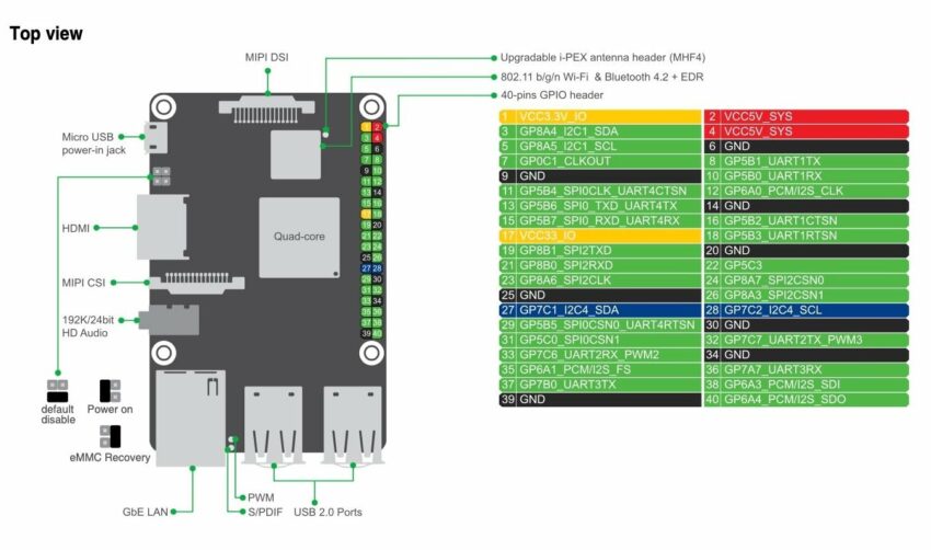

The 40-pin Raspberry Pi compatible, color-coded GPIO header provides access to GPIO pins, 2x SPI, 2x I2C, 4x UART, 2x PWM pins, and more. The Tinker Board R 2.0 houses a Realtek RTL8211E-VB-CG Ethernet controller, which is responsible for GbE support. Additionally, This board is equipped with Wi-Fi and Bluetooth capabilities, thanks to the Realtek RTL8723DS module.
