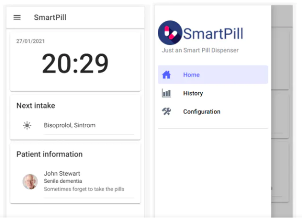

SmartPill Web Application
SmartPill system features two subsystems:
  • Smartpill Dispenser: A physical device that organizes, stores, and dispenses the pills. It also acts as the main interface for the patient.
  • Smartpill Web App: This is a web user interface that will enable the doctor or caregiver for the patient to configure and track patient intakes.
The web application features a nice friendly user interface, which enables the doctor to configure up to 4 different pills for each Smartpill Dispenser, and will select up to 3 intakes per day for each pill. This feature enables the doctor to change the dosage remotely whenever it is needed.
SmartPill system is designed taking into consideration the circumstances of some patients, like patients with senile dementia, Alzheimer or visual or audible impairments. Due to these health limitations, the dispenser is fitted with a large-format screen that will enable the patient to fill the pills in a comfortable way. It also features audible and light feedback that will remind the patient to take the pills at the right time. The patient does not have to worry about the placement of different pills in their position, the device Features a smart mechanism that distributes the pills inside the pill dispenser and dispenses the required dose at the right time. SmartPill Dispenser enables a wireless Internet connection to the AWS Cloud via the WiFi connection of the Microchip AVR-IoT board so that it can be remotely monitored and configured through the web application. The app also shows when the pills have been taken and will notify the caregiver if the pill is not taken.
