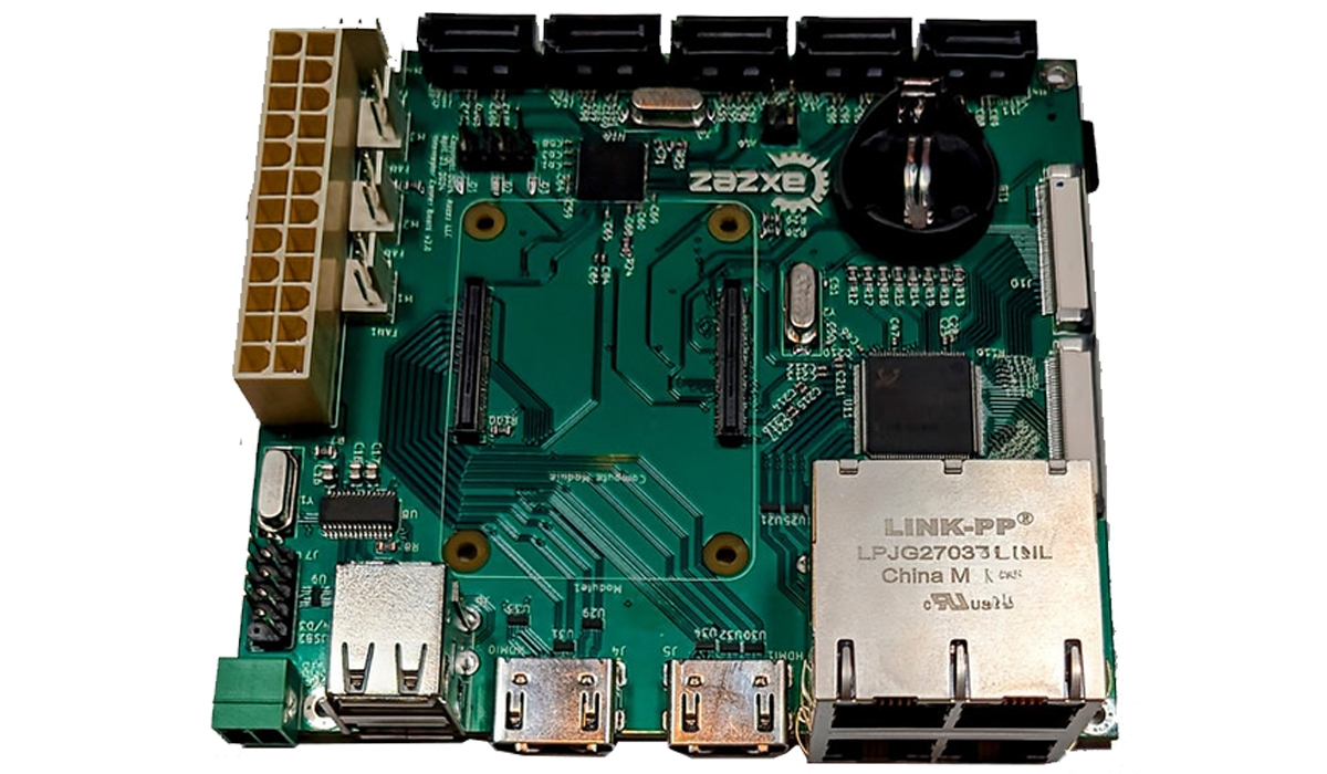

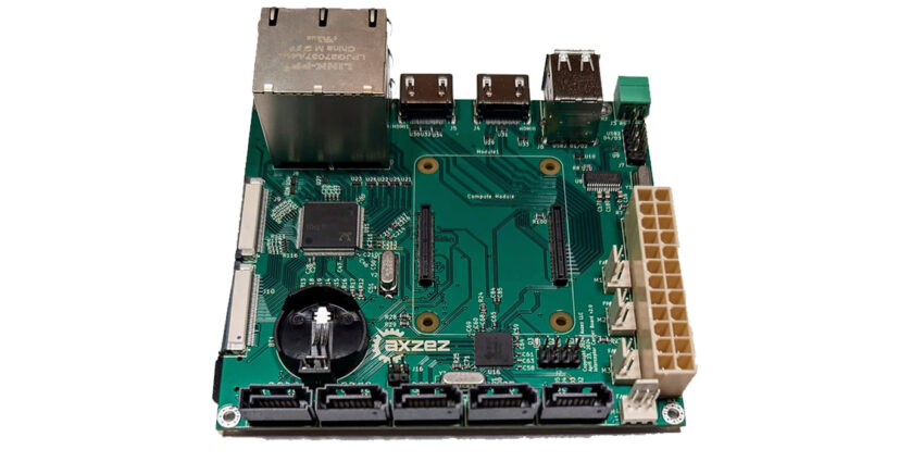

Interceptor Carrier Board v2.0
The Raspberry Pi CM5 has been officially verified as compatible with the Axzez Interceptor Carrier Board, including all its versions. Applications requiring high-performance computing with reliable storage and cooling, such as network storage systems or edge computing devices, primarily use this setup. Tested inside the Axzez Interceptor 3hdd 1u Case with active cooling, the CM5 runs at its full 2400MHz CPU frequency without throttling, even under heavy 24-hour workloads.
Major features include enhanced CPU and GPU performance, improved PCIe data throughput for faster HDD/SSD transfers, and compatibility with the WaveShare CM4 active cooling system using a 12v fan and thermal pad. However, the board lacks USB 3 support, disables the power-on button due to GPIO changes in the CM5, and currently does not support PoE without an updated Axzez OS.

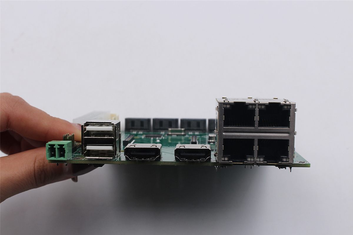

For storage, the carrier board supports up to five HDDs or SSDs using a JMB585 PCIe to SATA controller, with features like drive sleep, standby mode, and support for software RAID setups including RAID 0, 1, 5, 6, and 10. It also offers four gigabit Ethernet ports powered by an onboard RTL8367 switch for networking.
In terms of connectivity, the board provides four USB 2.0 ports—two through USB-B connectors and two via a 9-pin header. It also includes dual full-size HDMI 2.0 outputs with 4Kp60 support and an RS-485 port for serial communication.

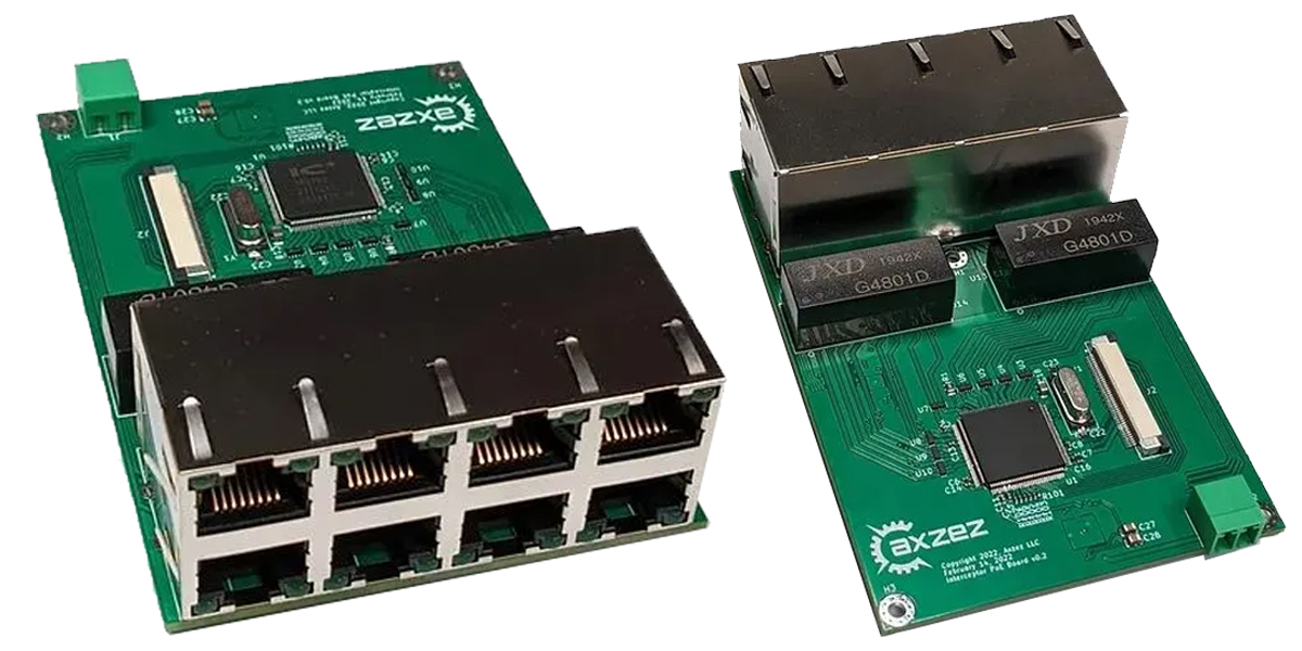

Interceptor PoE Board
Additional features include a microSD card slot, an RV3028 real-time clock with battery backup, and a standard 24-pin ATX power connector. The board also offers four 3-pin fan headers and an 8-pin header for connecting a power LED, button, and UART. Two 40-pin FFC connectors make it possible to add one or two Interceptor PoE boards, supporting up to 16 PoE+ ports.
