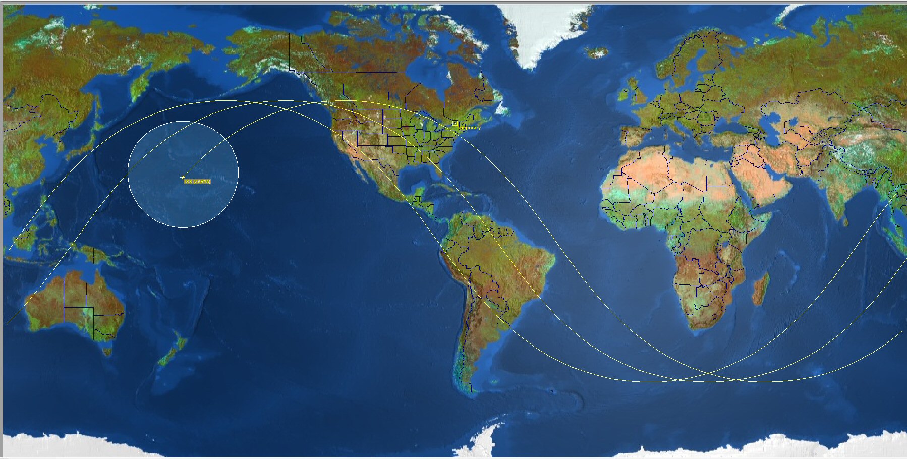

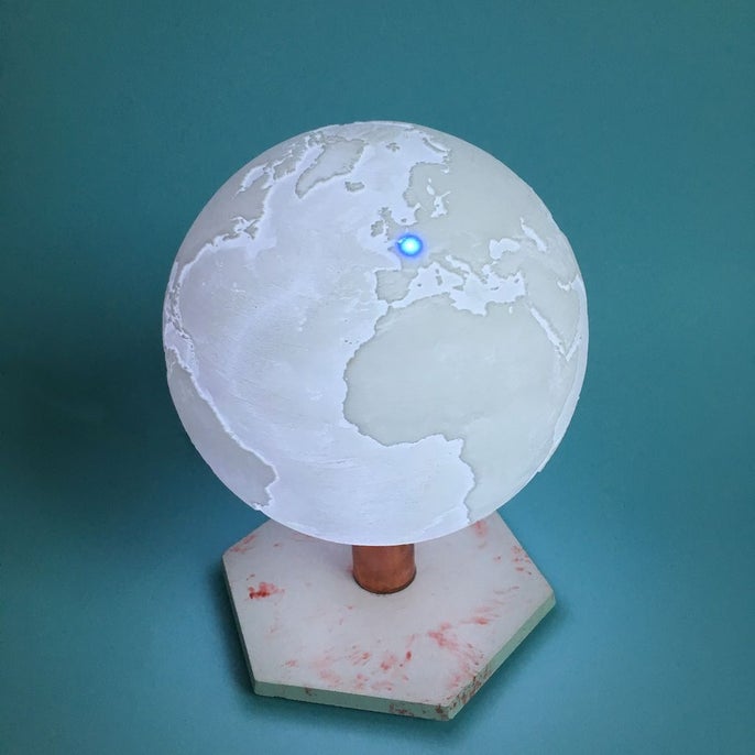

The ISS Tracking Lamp was designed by Antoine Seveau, and he provides a tutorial, explaining how you can produce yours. When switched off, the lamp has a minimalist white globe on a pedestal look. However, when you switch it on, a bright blue dot on the globe’s surface shows you exactly where the ISS is. The blue dot emitted from a laser pointer which is mounted inside of the globe, and that laser pointer is directed at the ISS’s current location, using coordinates from Open Notify—a service that gathers the data from NORAD and NASA. The lamp also displays the sunny side of Earth with Neopixels.

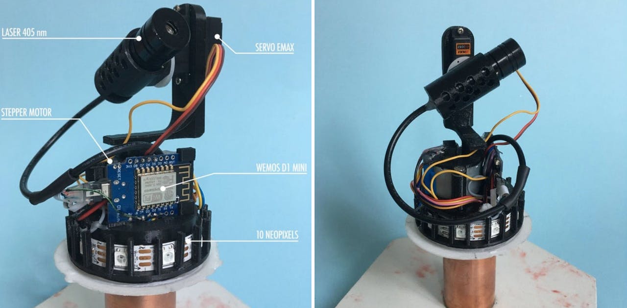

The globe for the project was purchased from AliExpress, but you can also 3D print it yourself as two hemispheres. Inside the globe, the laser pointer is mounted on a 3D-printed mechanism. Longitudinal position movement is performed by a stepper motor, and latitudinal position movement is handled by a servo motor. A Wemos D1 Mini ESP8266 board controls both the longitude and latitude functions, and uses the Open Notify API to find the ISS’s coordinates and then converts them into motor positions. There are 10 WS2812b single -addressable RGB LEDs around the base of the mechanism illuminate the globe from within. For fans of the space program, or you just want to know where the ISS is at any given time, this is an incredible project to embark on.
