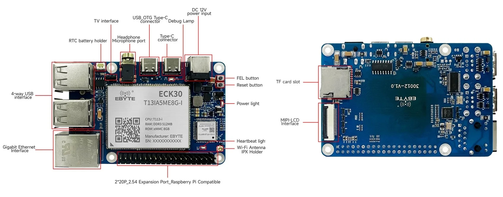

The Ebyte ECB30-P4T13IA5ME8G-I is a compact, credit card-sized industrial SBC powered by the Allwinner T113-i SoC. It combines a dual-core Arm Cortex-A7 CPU with a 64-bit RISC-V real-time core and is designed for rugged applications requiring wide temperature support from -40°C to 85°C.
The board features 512MB DDR3 RAM, 8GB eMMC storage, and a microSD slot. Connectivity options include gigabit Ethernet, WiFi 4, four USB 2.0 ports, and a 40-pin GPIO header compatible with Raspberry Pi. It lacks HDMI but supports display through a 26-pin MIPI DSI interface up to 1920×1080 @ 60 Hz. All these features its compact size, industrial-grade features, make it ideal for smart cities, smart homes, industrial control, and smart agriculture projects.

  • SoC: Allwinner T113-i
  • CPU: Dual-core Arm Cortex-A7 up to 1.2 GHz + 64-bit XuanTie C906 RISC-V real-time core
  • Memory: 512MB DDR3 (options for 256MB or 1GB available)
  • Storage: 8GB eMMC flash, optional 256MB SPI NAND flash
  • Display: 26-pin MIPI DSI connector supporting LCD and touchscreen up to 1920×1080 @ 60Hz
  • Video: H.265 decoding up to 4K@30fps, H.264 up to 4K@24fps, MJPEG encoding up to 1080p60
  • Audio: 3.5mm headphone and microphone jack
  • Networking: Gigabit Ethernet port, 2.4 GHz WiFi 4 with external antenna connector
  • USB: Four USB 2.0 host ports, one USB 2.0 Type-C OTG port
  • Expansion: 40-pin GPIO header compatible with Raspberry Pi pinout; supports I2C, UART, SPI, PWM, CAN Bus, PCM In/Out
  • Debug: USB-C debug interface
  • Power: 12V DC input via barrel jack
  • Additional Features: FEL and reset buttons, status LEDs (power, heartbeat, debug), RTC battery connector
  • Dimensions: 85 mm x 56 mm
  • Operating Temperature: -40°C to +85°C
