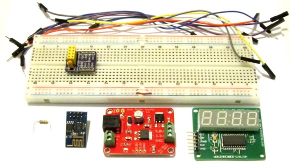

This clock retrieves time information from NTS and display it on a 4-digit seven segment LED display, and the connection to NIST time server through your local WiFi network will be by using ESP-01 WiFi module.
ESPclockBOM-580x337

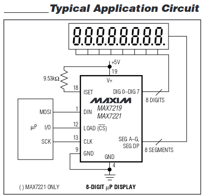

The 4-digit seven segment LED display breakout includes MAX7219 IC which is a seven segment driver. Three GPIO pins from ESP8266 module are used, where MAX7219 needs one for serial input,one for clock line and one to drive LOAD pin of MAX7219.
MAX7219_app
