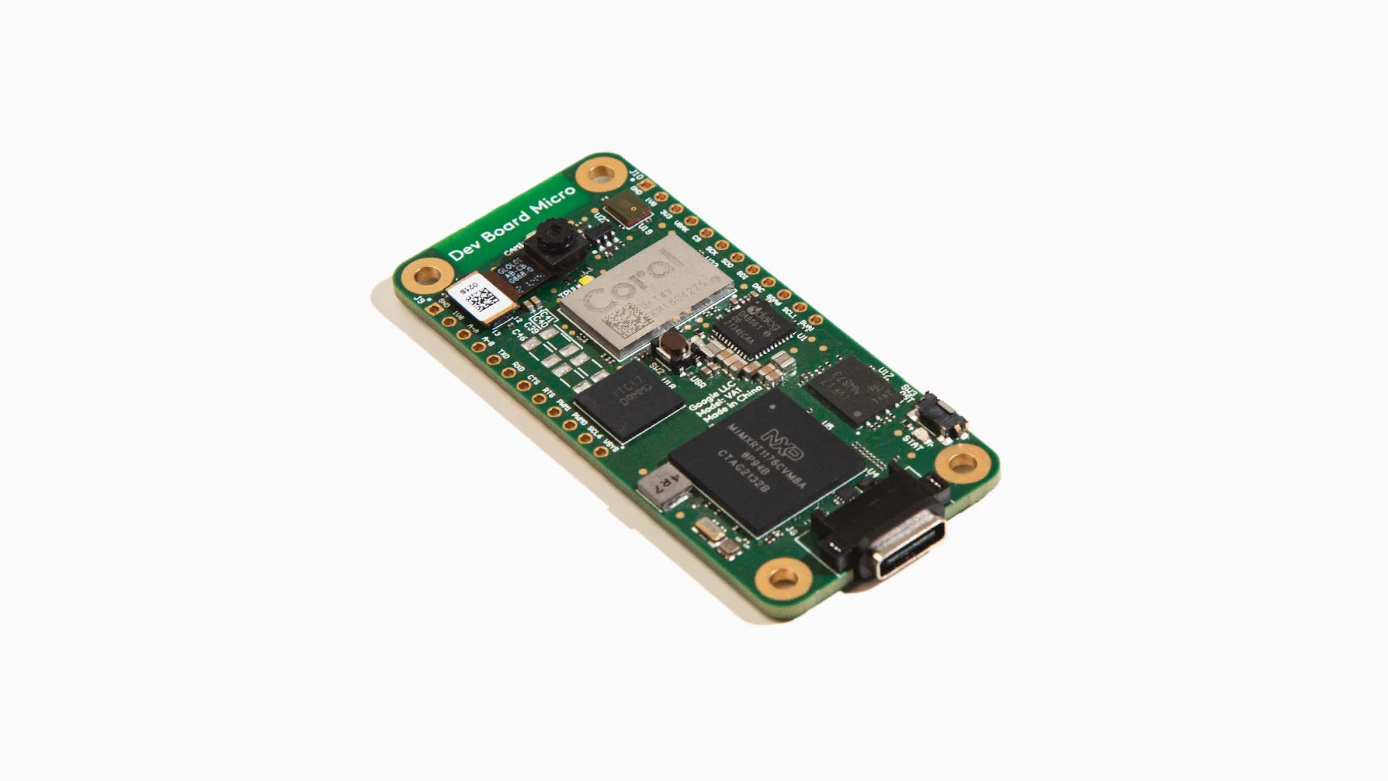

Official image of the Coral Dev Board Micro

The Coral Edge TPU (4 TOPS) is a small application-specific integrated circuit designed by Google that accelerates TensorFlow Lite models in a power-efficient manner. The Edge TPU  of the board is capable of performing 4 TOPS, with a dedicated function for inference linking of the neural networks. The on-device ML processing reduces latency, increases data privacy, and removes the need for a constant internet connection.
For input and output, the coral dev board provides a 2x 12-pin through-hole interface, 2x 100-pin board-to-board connectors, USB Type-C (USB 2.0), PWM, UART, I2C, SPI, DAC, etc. For the user interface, there are On-Board LEDs (one of which is user programmable) and two switch buttons-one as a reset button, and the other one is user programmable.
The user can set up a wireless add-on board as well as a Power over Ethernet (PoE) Add-on board. Amongst the many peculiar applications of the Coral Dev Board Micro, one of them is to build apps with FreeRTOS. It allows multitasking which is rare to find on microcontrollers. One can also tap into various multi-core applications as the dev board has both M4 and M7 processors.
