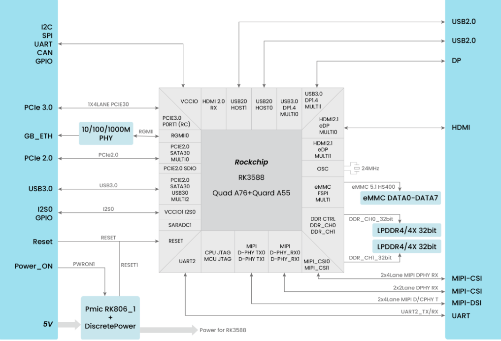

Mixtile, a well-known IoT hardware and compute module manufacturer, has recently announced the mixtile core 3588E System on Module. The SOM boasts a powerful Rockchip RK3588 SoC with a 260-pin SO-DIMM connector. The system designers at Mixtile designed the board to be compatible with NVIDIA Jetson TX2 NX carrier boards, making the integration process seamless.
The Rockchip RK3588 system-on-chip ships with four Arm Cortex-A76 high-performance cores at 2.4GHz and four Cortex-A55 low-powred cores at 1.8GHz. It also has a Mali-G610 graphics processor with 6 TOPS NPUs. There’s also 15GB eMMC storage as standard and support for an 8K video encoder and decoder. Designed with the latest 7nm Technology, the total TDP of this device is only 7W. The company has confirmed that the module includes four PCI Express Gen 3 lanes for external accelerators or other hardware integration.

  • SOC is A Rockchip RK3588.
  • Features an octa-core CPU with 4x Arm Cortex-A76 (2.4 GHz) and 4x Arm Cortex-A55 (1.8 GHz).
  • GPU is the Arm Mali-G610 MP4, supporting various graphic standards.
  • VPU supports multiple video formats, including 8K, and encodes 8K H.265/H.264 and JPEG.
  • NPU is 6 TOPS for generic AI tasks.
  • It comes with 8GB, 16GB, or 32GB LPDDR4 Memory configurations.
  • Internal storage is 32GB eMMC 5.1 flash.
  • It uses a standard 260-pin SO-DIMM, compatible with Jetson designs.
  • It has support for the SD 3.0 interface.
  • Has Support for HDMI 2.1 (up to 8Kp60), DisplayPort 1.4, and MIPI DSI.
  • Offers multiple MIPI CSI connections for cameras.
  • Audio can be accessed by interfacing with the 2x I2S ports.
  • supports a Gigabit Ethernet connection.
  • USB Port Includes 2x USB 3.0 and 2x USB 2.0 ports.
  • PCIe Features include a PCIe Gen 3.0 slot.
  • It requires 5V @ 3A via a USB-C port.
  • It measures 69.6 x 45 mm in size.
  • Operating Temperature is -20°C to 70°C and can be stored between -40°C to 85°C.
