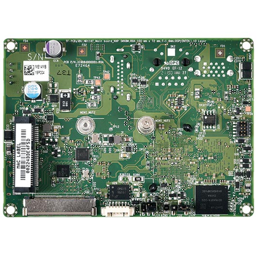

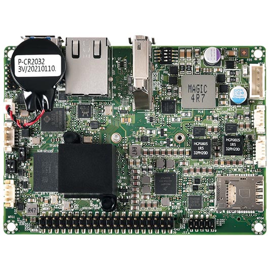

The ND118T board is characterized by an ARM-based platform combined with rich feature sets, low power consumption, and high-processing power and performance. It comes equipped with a 1.3 GHz NXP I.MX8M Cortex A53 dual/quad-core system-on-chip coupled with up to 32GB of eMMC storage, one microSD card slot, one GbE LAN port, a customized LPDDR4 onboard memory with options (1GB, 2GB, 4GB), a Raspberry Pi fully compatible 40-pin GPIO header, a MiniPCIe socket, and a Gigabit RJ45 LAN port. It is a perfect choice for embedded applications that require low power consumption in an industrial environment.
The board also offers dual display support with full 4K UltraHD resolution and HDR video quality as well as professional audio output at its highest level.
