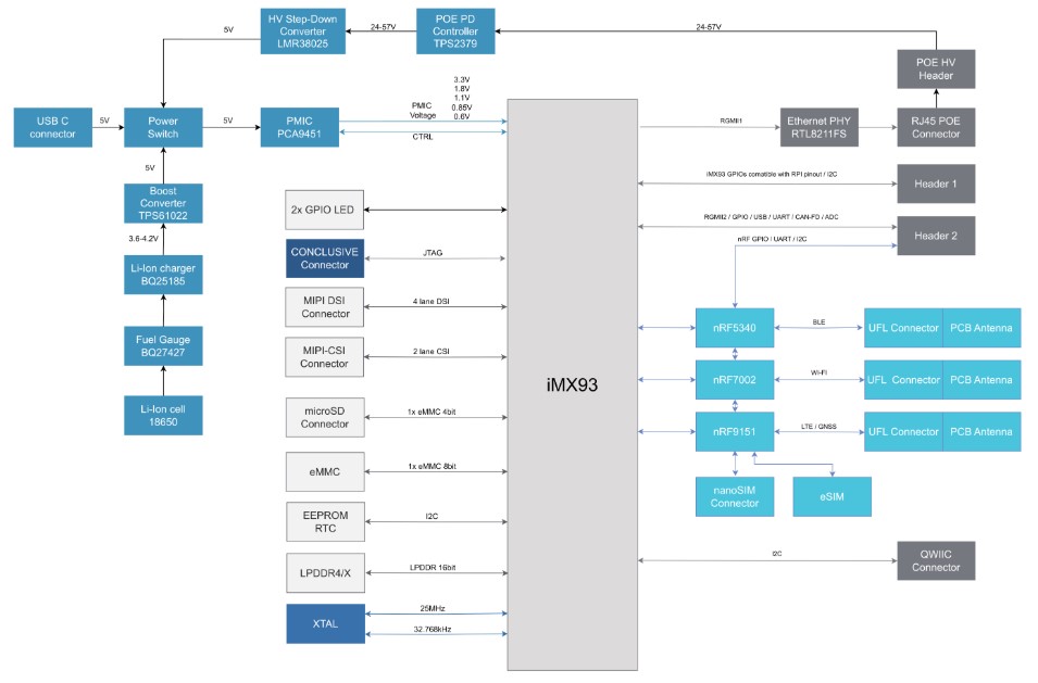

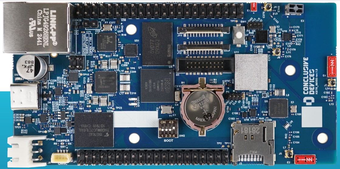

Conclusive Engineering has announced its upcoming Linux-capable Single Board Computer (SBC) named the Kestrel KSTR-IMX93. Powered by an NXP i.MX 93 Cortex-A55/M33 AI SoC and equipped with three Nordic Semiconductor wireless solutions, namely nRF5340 dual-core SoC, nRF9151 SiP, and nRF7002 Wi-Fi 6 cum BLE coprocessor, the KSTR-IMX93 SBC is a cutting-edge solution designed for the demands of modern embedded applications delivering unparalleled connectivity, robust processing power, and enhanced security features.
With support for a wide range of wired connectivity options and wireless protocols, Kestrel KSTR-IMX93 SBC features Gigabit Ethernet, dual-band Wi-Fi 6, Bluetooth 5.4 BLE, LTE Cat-M1/NB-IoT, Thread, Zigbee, and GNSS.
Kestrel KSTR-IMX93 SBC specifications:
  • SoC: NXP i.MX 93
    • Up to dual-core Arm Cortex-A55 @ 1.7GHz
    • Arm Cortex-M33 core @ 250MHz for real-time tasks
    • Arm Ethos-U65 NPU @ 1GHz delivering up to 0.5 TOPS
    • PXP 2D GPU for image composition and processing
    • 640KB on-chip OCRAM with ECC support
  • Memory and Storage:
    • 512MB, 1GB, or 2GB LPDDR4/LPDDR4x RAM
    • Up to 128GB eMMC flash
    • MicroSD card slot
  • Display and Camera:
    • MIPI DSI display interface
    • MIPI CSI camera interface
  • Networking and Wireless:
    • Gigabit Ethernet port via Realtek RTL8211FS (RGMII)
    • Nordic nRF5340 SoC with dual Cortex-M33 cores supporting: Bluetooth 5.4 BLE, Mesh, NFC, Thread, Zigbee, 802.15.4, ANT, 2.4GHz proprietary
    • Nordic nRF9151 SiP:
      • GPS/GNSS
      • LTE Cat-M1, NB-IoT, and DECT NR+ connectivity
    • Nordic nRF7002 companion IC with dual-band Wi-Fi 6 and BLE
    • Built-in eSIM/Soft SIM support
  • USB: USB 2.0 OTG via Type-C port
  • Security:
    • NXP EdgeLock Secure Enclave
    • Arm TrustZone technology
  • Expansion:
    • 40-pin Raspberry Pi-compatible GPIO header (i.MX93 only)
    • 44-pin GPIO header shared between i.MX93 and nRF SoCs
  • Misc:
    • 1x Gigabit Ethernet with TSN and CAN-FD transceiver
    • 4x UART, 3x I2C, 1x SPI
    • 4x ADC channels
    • Up to 37 GPIOs for i.MX93
    • Up to 15 GPIOs for nRF SoCs
    • JTAG debug connector
  • Power:
    • 5V input via USB Type-C
    • External Li-Ion battery support with charging, level, and temp monitoring
    • PoE support via IEEE 802.3af on RJ45
  • Dimensions: 110 x 55mm
The Kestrel KSTR-IMX93 SBC supports Linux 6.1 and 6.5-based distributions, including Canonical’s Ubuntu, as well as custom Yocto and Buildroot builds. It also supports FreeBSD (available on request) and Zephyr RTOS on the Cortex-M33 core of the NXP i.MX 93 SoC, as well as on the nRF5340 SoC and nRF9151 SiP.
Thanks to its versatile connectivity and processing capabilities, the KSTR-IMX93 SBC is well-suited for a wide range of applications, including industrial automation, smart home systems, healthcare devices, and automotive solutions.
