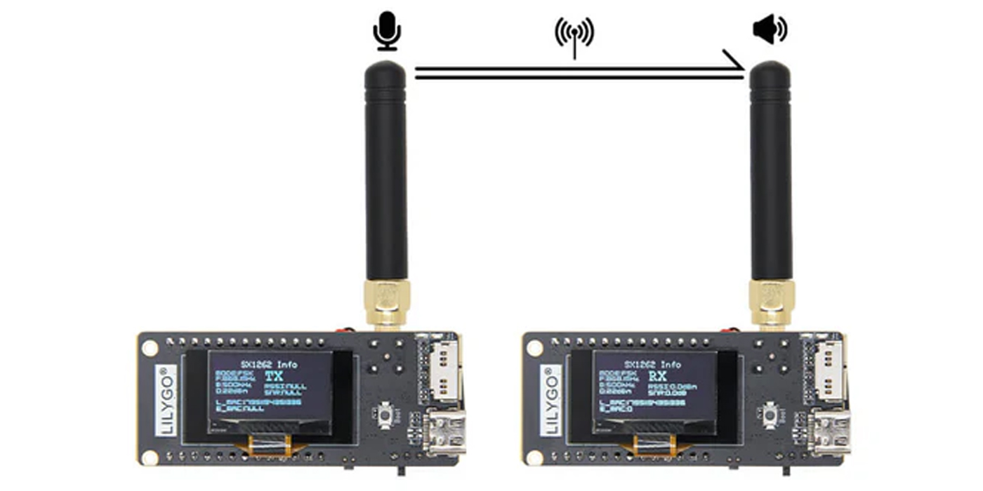

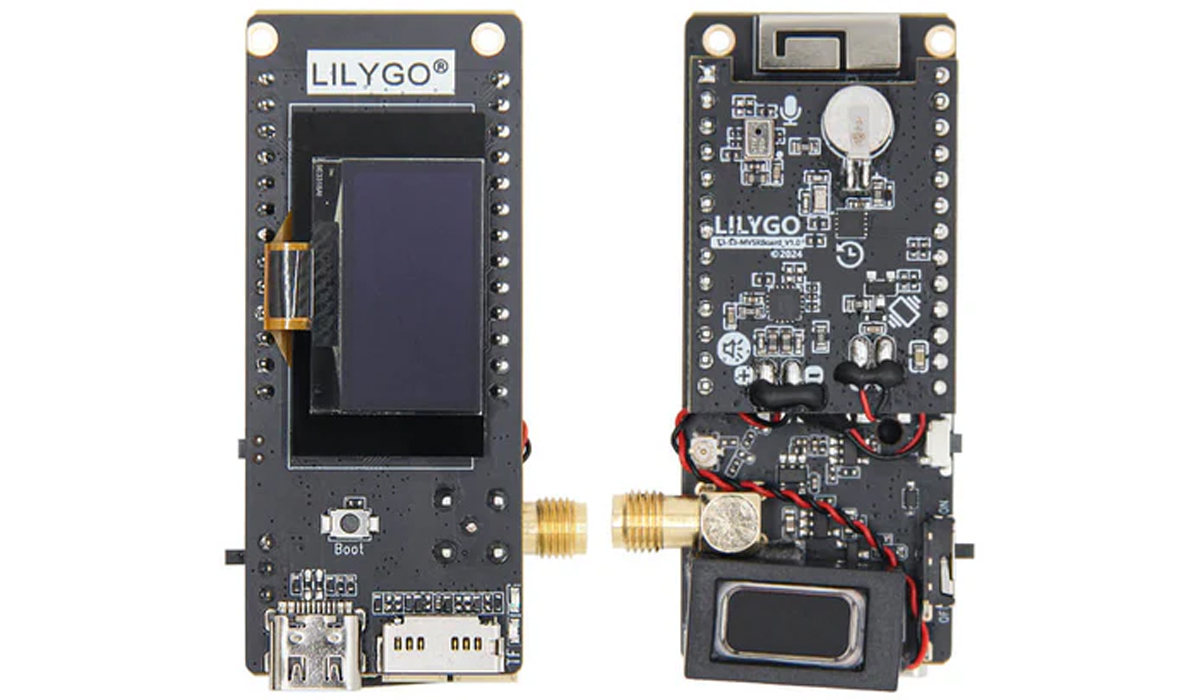

The T3-S3 MVSR by LILYGO is a compact LoRa voice communication kit designed for long-range audio transmission using LoRa technology. It features a built-in vibration motor, speaker (MAX98357A), microphone (MSM261S4030HOR), and a 0.96-inch OLED display with a resolution of 128×64, driven by the SSD1306 I2C interface.
At its core, it is powered by the ESP32-S3FH4R2 MCU with 4MB Flash and 2MB PSRAM, and it supports 2.4GHz Wi-Fi and Bluetooth 5.0. It includes onboard Reset, Boot buttons and microSD card support and is powered via USB or a 3.7V LiPo battery with a charging input of 5V 500mA. With its compact size of 66 x 15 x 27mm, the T3-S3 MVSR is ideal for remote voice communication projects, DIY wireless intercom systems, and educational or experimental IoT applications.
It is not the first time we are talking about the LoRa voice communication board, as we have previously covered the TTGO LoRa32 development boards, which add LoRa to the onboard communication features. LoRa has been used for peer-to-peer and mesh messaging with firmware like MeshTastic. However, its low bandwidth puts some limitations on what it can handle.

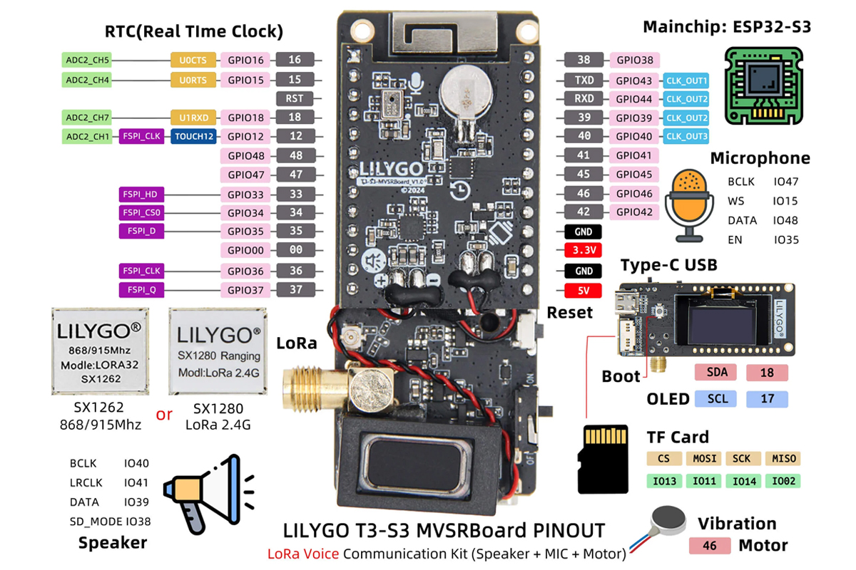

T3-S3 MVSR board pinout
GitHub provides sample code and basic instructions for the T3-S3 MVSR LoRa Voice communication kit so you can easily start and try things out. You can go to our GitHub community and explain the issue you’re facing, and someone from the team will help you out.
