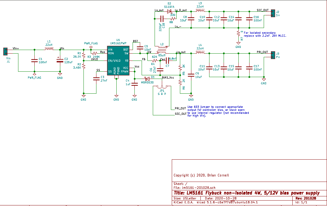

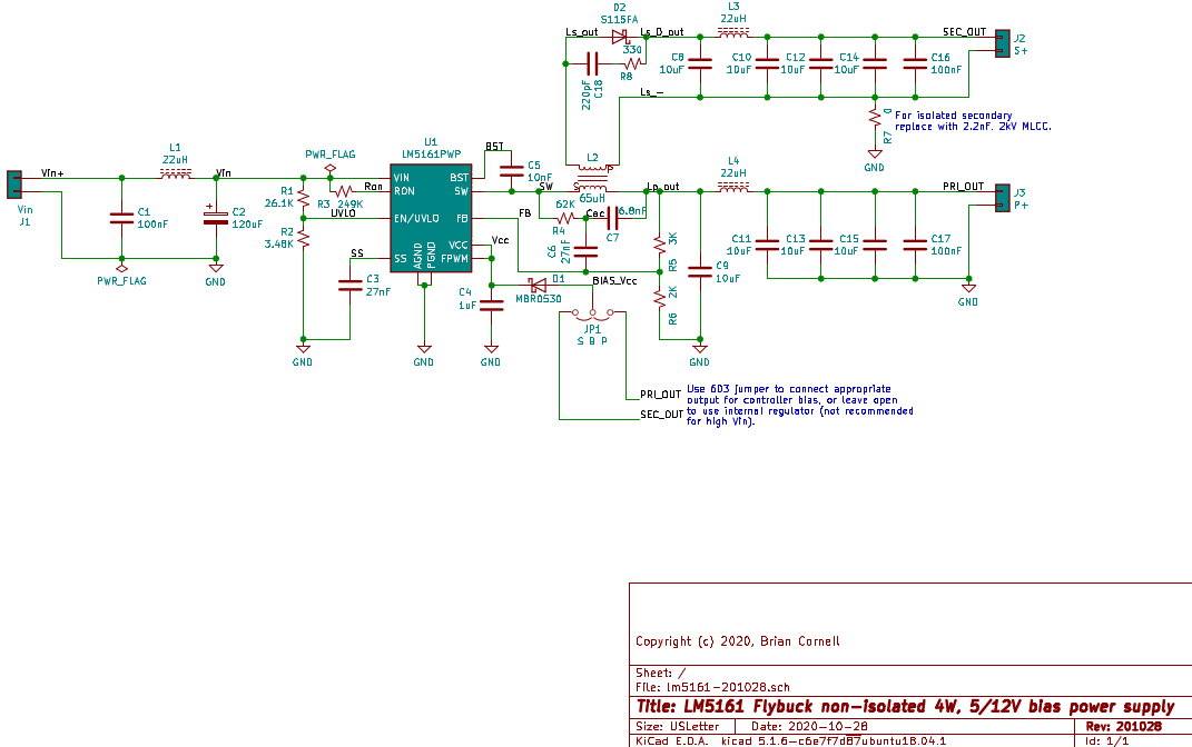

The LM50xx family of regulators is non-isolated buck regulators known for a number of incredible features including simplicity, low-cost wide Vin range, and output configuration flexibility. Cornell started by adding extra windings to obtain outputs at different voltages which could be tied to the primary ground or isolated. He then used a constant on-time PWM scheme to eliminate the traditional compensation network required to close the control loop. The artifact of the constant on-time control scheme however showed the control loop requires some ripple for stability (a contributing factor is the small output capacitance) so he went ahead to add a small LC filter to the output to solve this problem.
Cornell, however, noted that the LM5017 has a current limit of 600mA which would not be enough to handle the power required of both outputs, but one can use the LM5161 which is a higher power sibling of LM5017 that integrates more features.
SPECIFICATIONS (as configured)
  • Vin 10.6 – 30V DC (tested to 25V)
  • # Outputs – 2 (V1, V2)
  • V1 – +5V, 300mA, 1.5W, non-isolated
  • V2 – +12V, 200mA, 2.4W, [non]-isolated
  • Output ripple: V1 < 10mV P-P, V2 < 20mV P-P
  • Regulation: V1 – 1%, V2 – 11% (over Vin range, V1 & V2 @ full load)
  • Transient response (3mS pulse, 20%->100% load)
    V1 – 250uS
    V2 – 960mV droop
  • Peak efficiency: 84.5% (V_in=14V, V1 & V2 @ full load)
  • Average efficiency: 83% (over Vin range, V1 & V2 @ full load)
  • Low efficiency: 81.5% (Vin=10.6V, V1 & V2 @ full load)
  • Radiated EMI: not tested
  • Operating temperature: -40C (characterized) – +85C (tested)
  • Soft start
  • Protection: over current, thermal shutdown
  • Dimensions(LWH): 4.7cm x 2.3cm x 1.6cm (1.85″ x 0.91″ x 0.63″)
  • Unit cost: $23.00 (excluding assembly time & materials)
Cornell has released the schematic and KiCad project files as well as supporting data for the board, but you may want to read the full details of the project before going ahead to build one for yourself. The design, inherent to the controller architecture, has a lot of “problems” including secondary regulation, conditional stability, and the current limit scheme used but “as long as these are understood,” he says, it can be used successfully.
