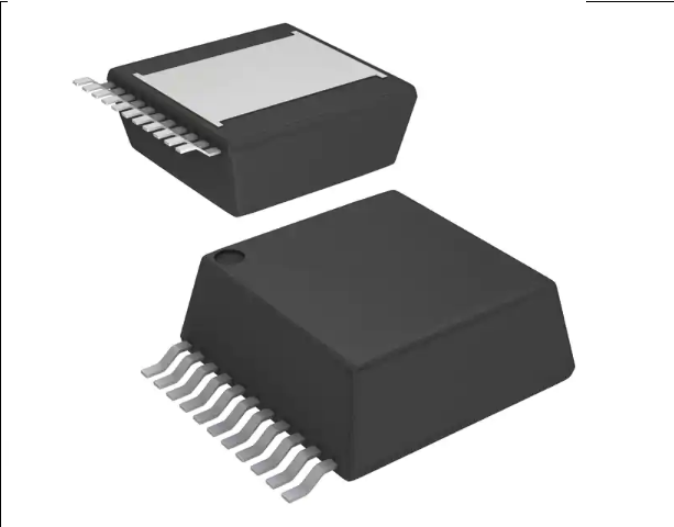

LMZ12008 Power Modules Series have integrated Inductor
48W, 8A SIMPLE SWITCHER® Power Module with 20V Maximum Input Voltage. The LMZ12008 SIMPLE SWITCHER© power modules are an easy to use step down DC to DC solution capable of driving up to 8A load.

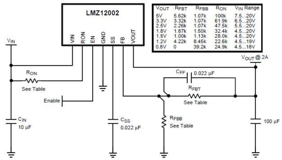

Typical Application
