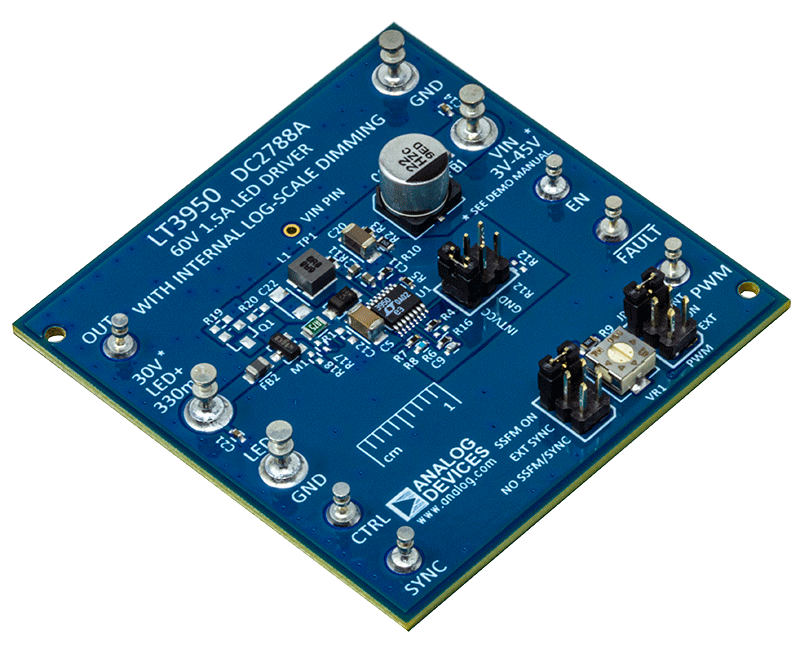

DC2788A is a boost LED driver featuring the LT3950. This demonstration circuit powers a string of LEDs at 330 mA. The step-up topology can be used to drive a string of up to 28 V of LEDs as assembled. The maximum output voltage capability of the LT3950 is 60 V. DC2788A runs from an input voltage range of 6 V to 24 V as built. It also runs at 2 MHz and has the capability to turn on spread spectrum frequency modulation (SSFM) for a frequency range of 2.0 MHz to 2.5 MHz. Dimming control can be achieved with analog dimming or PWM dimming either from an external or an internally generated clock source. DC2788A features undervoltage lockout (UVLO) set at 6.6 V with a 1.0 V hysteresis for turn-on.
The UVLO voltage, LED current, output voltage range, switching frequency, brightness control, SSFM, and the topology can all be adjusted with simple modifications to the demonstration circuit.
