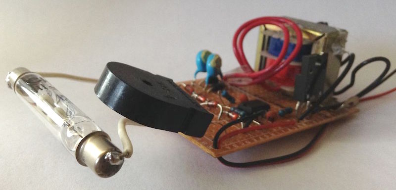

More recently, tanner_tech published an Instructable on building a similar Geiger counter using a single 555 timer and a piezo buzzer. His GM tube operates at a much lower voltage (~400V).
Geiger counter made by [tanner_tech]
