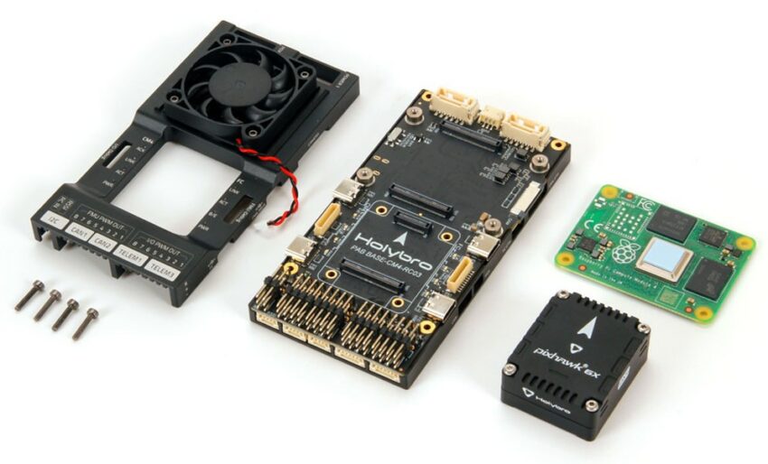

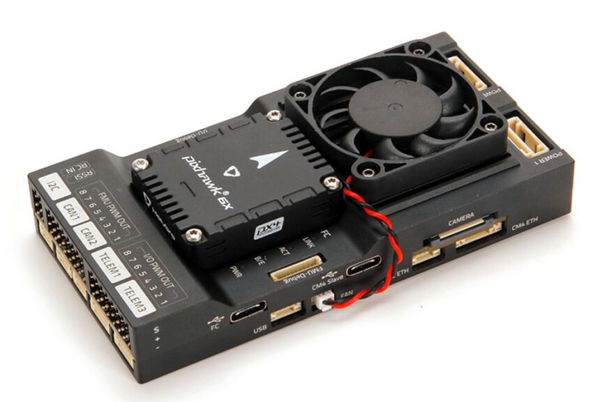

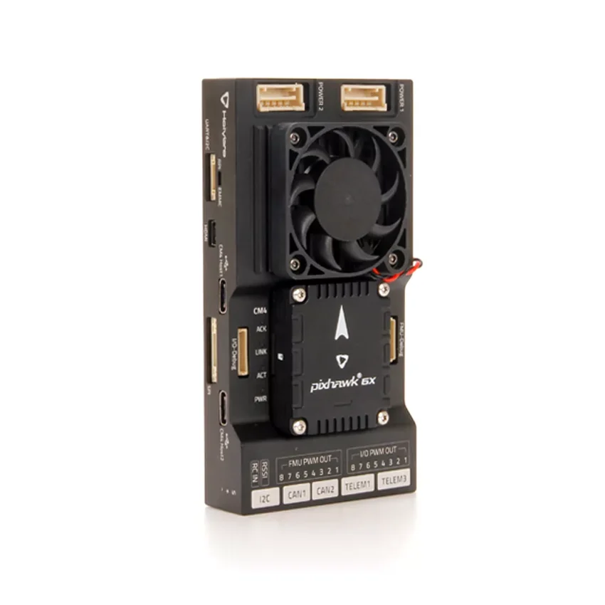

“The Holybro Pixhawk RPi CM4 Baseboard combines the Pixhawk FC module with the Raspberry Pi CM4 companion computer in a compact form factor with all the connections you need for development,” the company explains. “It follows the Pixhawk Connector and Autopilot Bus Standard, allowing easy swap of FC Module with any FC that follows the Pixhawk Bus Standard. The FC Module is internally connected to RPi CM4 through TELEM2, and can also be connected via ethernet cable with an external cable provided. It is compatible with the Pixhawk 5X & 6X flight controller module.”
Features and Specifications of the Holybro Pixhawk RPi CM4 Baseboard Include:
  • 1x CSI camera for the Raspberry CM4
  • 1x mini HDMI port for Raspberry Pi CM4
  • 1x 4-pin FC Ethernet port
  • 1x CM4 Ethernet port
  • 2x GPS ports
  • 1x each of I2C, SPI, UART/I2C ports
  • 2x CAN ports
  • 3x Telemetry ports
  • 1x DSM port
  • 2x CM4 Host and 1x CM4 Slave ports
  • 1 x FC port
  • 1x DIP switch to select the CM4 Host/Slave modes
  • 1x USB port
  • 1x I/O and 1x FMU Debug ports
  • 1x FAN connector
  • 4x CM4 and 1x FC status LEDs
  • 2x Power connectors and 1x USB Type-C for RPi CM4
The RPi CM4 is powered with the PM03D power module via a 4-pin to USB-C cable. The power module comes with up to six XT30 connectors for motor ESCs and battery and a selectable 8V/12V triple row pin header for powering peripheral devices. It is compatible with the Pixhawk 5X and 6X flight controllers.
The company is selling the product for $279 and it comes with the Pixhawk RPI CM4 Baseboard, a cable set and the PM03D Power Module. There’s a second option which is offered for $590 but it comes with a Pixhawk 6X Flight Controller Module. You can check the product page for more information on purchases.
