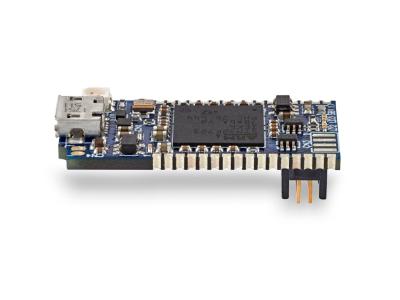

The only downside to the PX-HERO, howbeit, understandable, is the lack of an onboard debugger which according to Piconomix, will increase the board’s power consumption. As such, to provide the fine resolution and insightful view into your firmware, you will need a good in-circuit debugger. To make acquiring the debugger easy and seamless, Piconomix, will be giving backers the opportunity to acquire the STLINK-V3MINI low cost, high-performance in-circuit debugger and programmer for STM32 along with the PX-HERO board.
STLINK-V3MINI Debugger and Programmer
