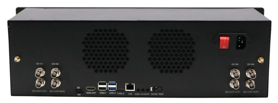

Mekotronics Rockchip RK3588 4K Video Encoder back view
Specifications of the Mekotronics Rockchip RK3588 4K Video Encoder
  • CPU {8 cores CPU, Quad-core Cortex A76 @2.4Ghz, Quad-core Cortex A55 @1.8Ghz}
  • GPU {Mali-G610 GPU, OpenGL ES 1.1/2.0/3.2, OpenCL 2.2, Vulkan 1.2, 8K 10-bit decoder, 8K encoder}
  • NPU {6.0 TOPS NPU, Tensorflow, Caffe, Tflite, Pytorch, Onnx NN, Android NN, etc}
  • Chipset {Rockchip RK3588, Octa-core (quad-core Cortex A76 and quad-core Cortex A55)}
  • DDR {LPDDR4X 8G}
  • Internal storage {Support eMMC5.1, 64GB}
  • OS {Android 12, Buildroot, Debian, Armbian}
  • HDMI output {HDMI 2.1, max output-8K, 60Hz}
  • SDI input {SDI inputs x4 (SDI 1 is 12G; and SDI 2, 3, 4 is 3G)}
  • SDI loop {SDI loop x4}
  • Screen panels {7-inch display at front panel}
  • Ethernet {G-LAN network 1000Mbps}
  • WiFi {WiFi 6, IEEE 802.11 a/b/g/n/ac/ax MIMO, max. speed- 3.5 Gbps}
  • Clock {Support RTC clock}
  • USB {USB3.0 x2, USB2.0 x2, Type-C x1}
  • PCIE {PCIE 3.0 M.2 M-key, support NVMe SSD size 2280, lane speed- 1 Gbps}
  • Mini PCIe {Mini PCIe for 4G LTE/GPS module}
  • SIM card slot {Support Nano SIM card for 4G}
  • SD card {Micro SD card slot, max. capacity- 1TB, max. speed- 312 Mbps}
  • Audio {Line-in, Line-out, Audio out with microphone}
  • Built-in fans {Build-in fans x2}
  • Aluminium Chassis {Aluminium chassis, 3U design, size at 48.2*15*13.3cm}
  • AC power {110~220V}
