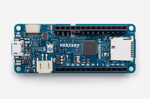

Arduino had announced a new member of its family: MKRZero! This new board comes with the size of 61x25mm MKR1000 board and the power of ARM-core Arduino Zero.
The ARM-core board consists of an on-board SD connector with dedicated SPI interfaces (SPI1) that make it easy to browse your files with no extra hardware.
You can power your MKRZero using a micro-USB cable or a LiPo battery, but you should pay attention that the operation voltage is 3.3.V and applying higher voltages to any I/O pin will ruin the board. To guarantee the voltage, you can use a battery and monitor it using analog converter.
The small size, low power consumption, integrated battery management, and integrated SD management are some of the advantages of this great tiny board.
MKRZero has 22 digital I/O pins, 12x PWM, 1x UART, 1x SPI, 1x I2C,32x LED_BUILTIN, 7x analog input pins, 1x analog output and 8x external interrupts. Here are the hardware specifications:
