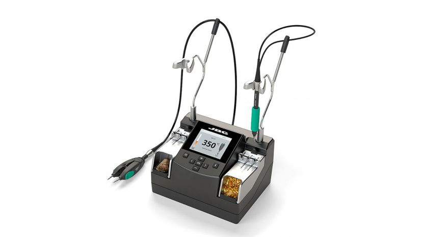

NASE 2 Tools Nano Rework station from JBC Tools
NASE 2 Tools Nano Rework station is one of the best solutions for soldering and rework of SMD components requiring the highest precision. It works simultaneously with the NT115-A Nano Handpiece and the AN115 Steady Nano Tweezers.
NASE 2 Tools Nano Rework station is one of the best solutions for soldering and rework of SMD components requiring the highest precision. It works simultaneously with the NT115-A Nano Handpiece and the AN115 Steady Nano Tweezers. The short distance from the tip to the handle offers maximum control even when using a microscope.

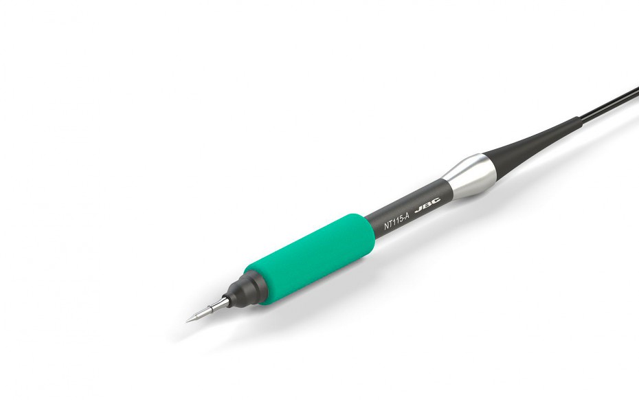

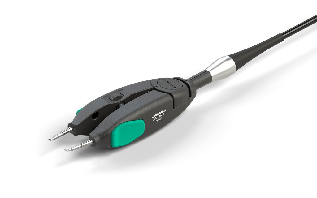

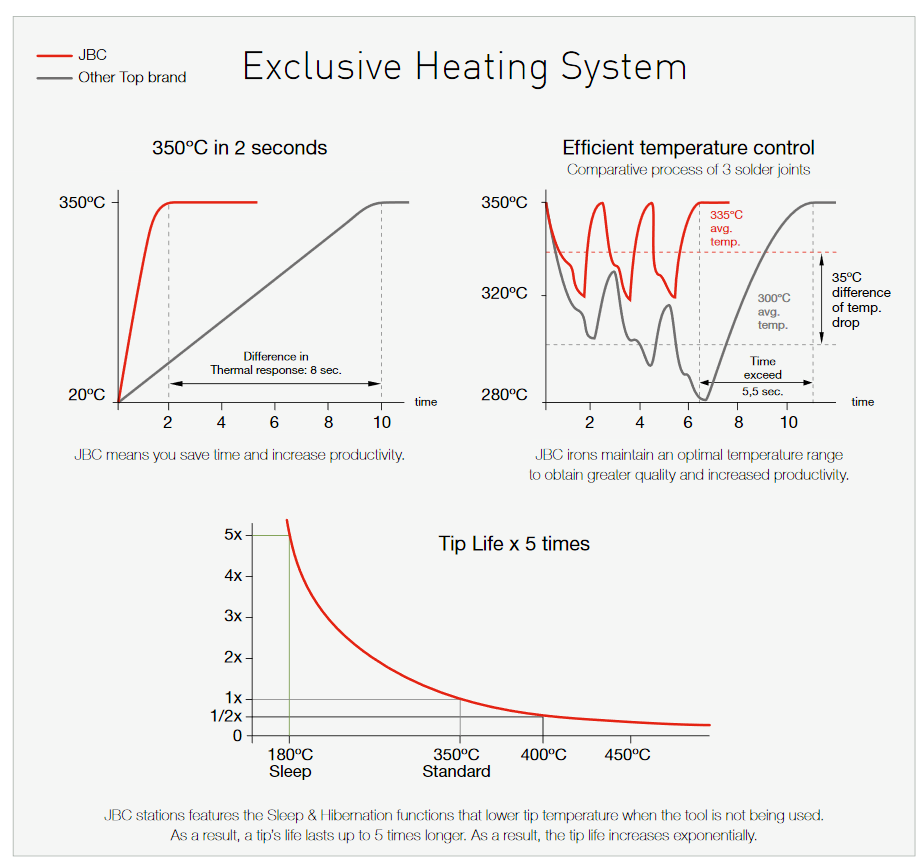

Temperature Dynamic Profiles
The NASE-C comes with the new Temperature Dynamic Profiles functionality. The use of these profiles allows you to control the temperature of the component during all the phases of the soldering process, emulating the heating process in a reflow oven.

  • Dynamic Soldering Profiles: Designed to avoid thermal shock when soldering Ceramic Chip components like MLCC, this new and unique feature allows controlling the heating ramp up rate of the tool to gradually increase the temperature of the component through all the phases of the soldering process.

  • Sleep and Hibernation mode: These modes lower soldering tip temperature when the tool rests in the stand in order to avoid oxidation and extending tip life.
