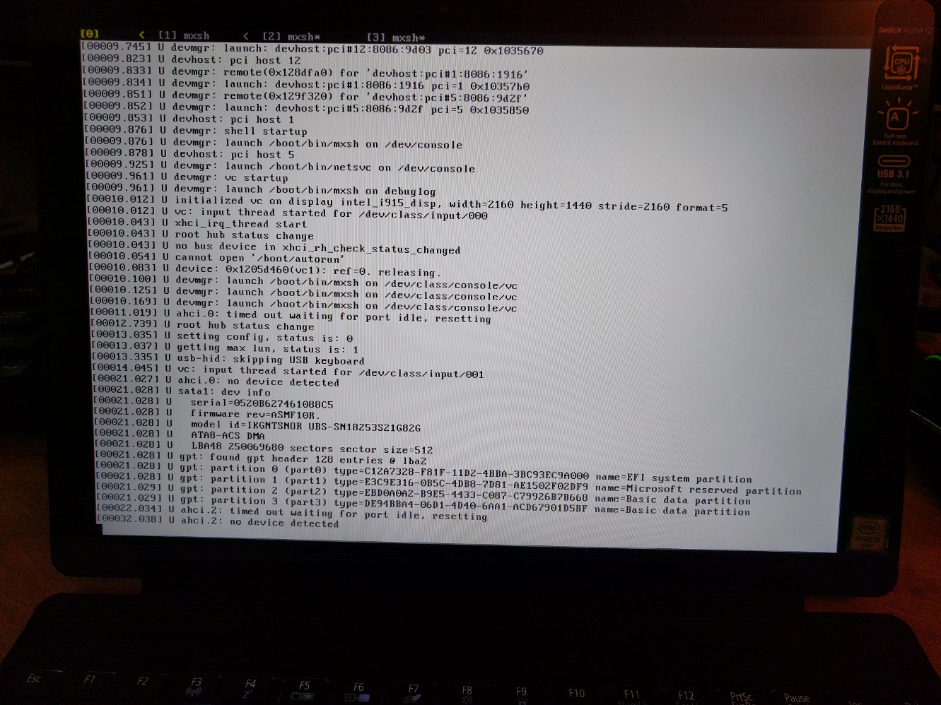

Brian Swetland showed a shot of virtual console 0 with the tail end of the boot log on an Acer Switch Alpha 12.
Image courtesy of Brian Swetland
