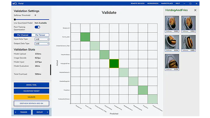

In terms of software, NXP’s elQ ML software development environment will offer machine learning and run-time inference for the MCX microcontrollers. By using the easy-to-use tools provided by eIQ, developers can train ML models that are intended for either the NPU or the CPU core and then deploy them on the MCU. According to NXP’s security-by-design methodology, MCX families will provide a secure boot with an immutable root-of-trust, hardware-accelerated cryptography, and an integrated EdgeLock secure subsystem. Therefore, for embedded systems intended for edge deployment, the most crucial design factor is the integration of security features.
