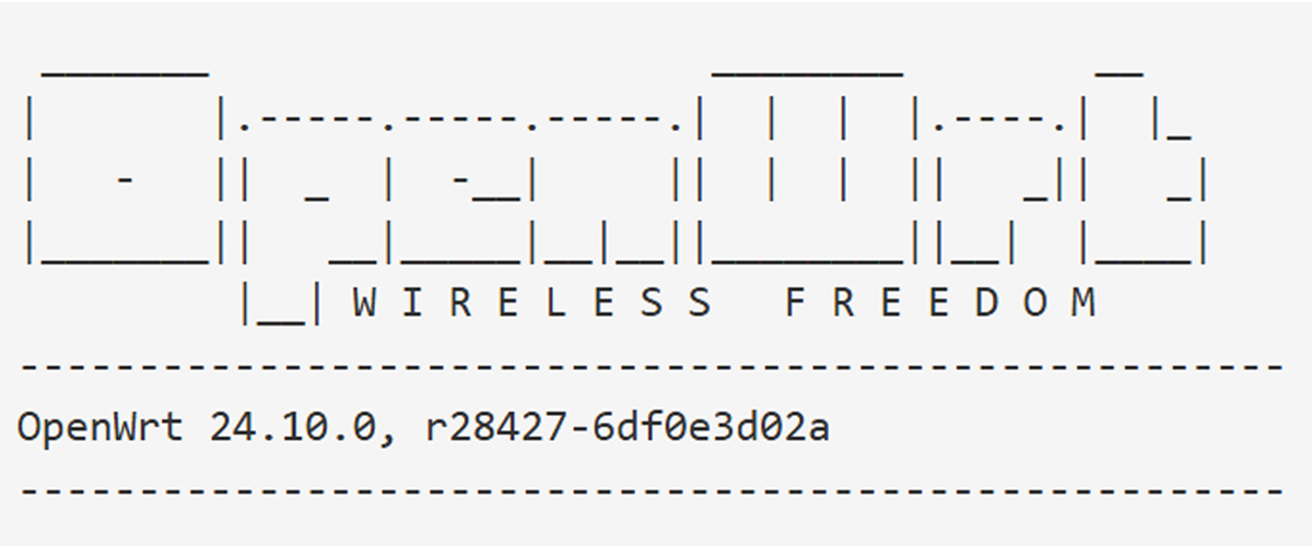

OpenWrt 24.10.0 is the first stable release in the OpenWrt 24.10 series, a Linux-based operating system designed for embedded devices such as routers, network switches, and IoT hardware.
It replaces vendor-supplied firmware, offering advanced customization, improved security, and extensive networking capabilities. The update includes over 5400 commits, upgrading the Linux kernel from 5.15 to 6.6, adding TLS 1.3 support, enhancing WiFi6 (802.11ax) compatibility, and introducing initial WiFi7 (802.11be) support. Notable changes include Multipath TCP activation, improved Link Layer Discovery Protocol (LLDP) support, and a refined package management system, which maintains OPKG while dropping APK support.
More than 100 new devices now support compatibility, bringing the total supported devices to over 1970, with added targets for AllWinner D1, Intel XScale IXP4xx, LoongArch CPUs, StarFive JH71x0, and STM32 SoCs, while developers removed older targets like ath25, bcm63xx, and octeontx.
Developers updated core components, including musl libc 1.2.5, glibc 2.38, gcc 13.3.0, and binutils 2.42. The upgrade process from OpenWrt 23.05 is mostly seamless via sysupgrade, but certain devices, such as the Qualcomm Atheros IPQ806X and Zyxel GS1900, require specific upgrade procedures.
