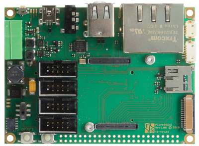

PicoCore™MX8MP Starter Kit
The company is also offering a ready-to-run PicoCore™MX8MP Starter Kit for an easy start of development. This kit includes an LVDS-equipped V4I-LIN version of the PicoCore MX8MP, a 7-inch analog-resistive PCAP touch panel, and a compact baseboard with dual GbE ports, dual USB host ports, micro-USB OTG port, microSD slot, and audio I/O jack.
The Starterkit is currently available for pre-order at $436 with delivery scheduled for later this quarter.
