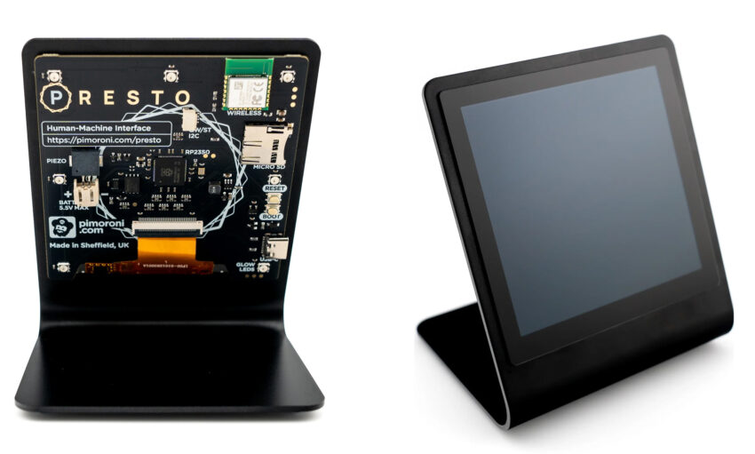

The Pimoroni Presto is a compact 4-inch wireless desktop touch display development board built around the Raspberry Pi RP2350 MCU, which uses the Raspberry Pi RM2 wireless module, for both WiFi 4 and Bluetooth connectivity.
Designed for desktop use, it features a square 480×480 capacitive touchscreen, 8MB PSRAM, 16MB QSPI flash, a microSD card slot, USB-C power/programming port, and Qwiic/STEMMA QT expansion. It also includes seven RGB LEDs for ambient lighting, a piezo speaker, and comes mounted on a sleek black anodized aluminum stand. Pre-installed with MicroPython, it has various demo apps like a clock, photo frame, and environmental dashboards (requiring Qwiic sensors). With this feature, it targets developers, educators, and hobbyists looking for a visually appealing, WiFi-enabled HMI or IoT interface.

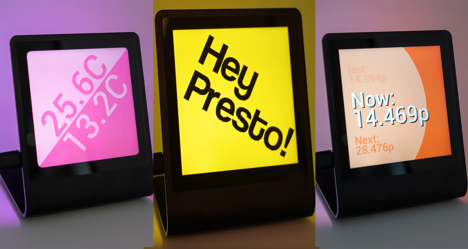

Pimoroni Presto ships with a MicroPython-based GUI pre-installed, making it easy to get started with touchscreen interfaces, sensor integration, and WiFi-enabled applications right out of the box. A built-in launcher offers several demo apps, including a stopwatch, photo frame, tomato timer, analog clock, and 3D animations. Additional MicroPython samples are available for I²C Qwiic modules, such as environmental sensors and an attitude indicator. If you want to get more information about the product or you want to get to low-level control for the device, you can check out the boilerplate project, which is a C++ development template provided by Pimoroni on GitHub.

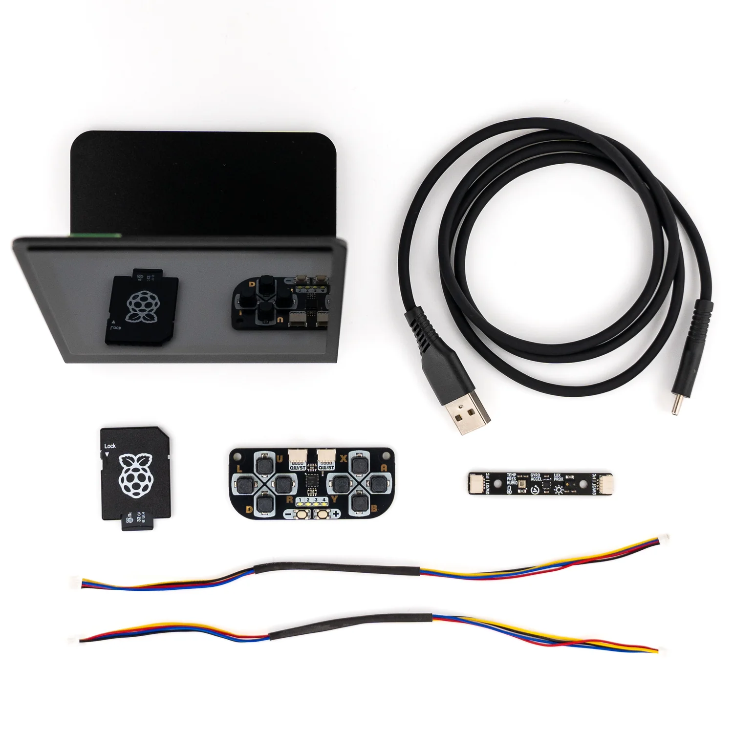

The Pimoroni Presto display development board with an RP2350 MCU is priced at £69. If you want to make things simple and get started with you can get the full starter kit for £99. It includes the display, USB-C cable, microSD card with adapter, Qw/ST pad, sensor stick, and two Qw/ST cables.
