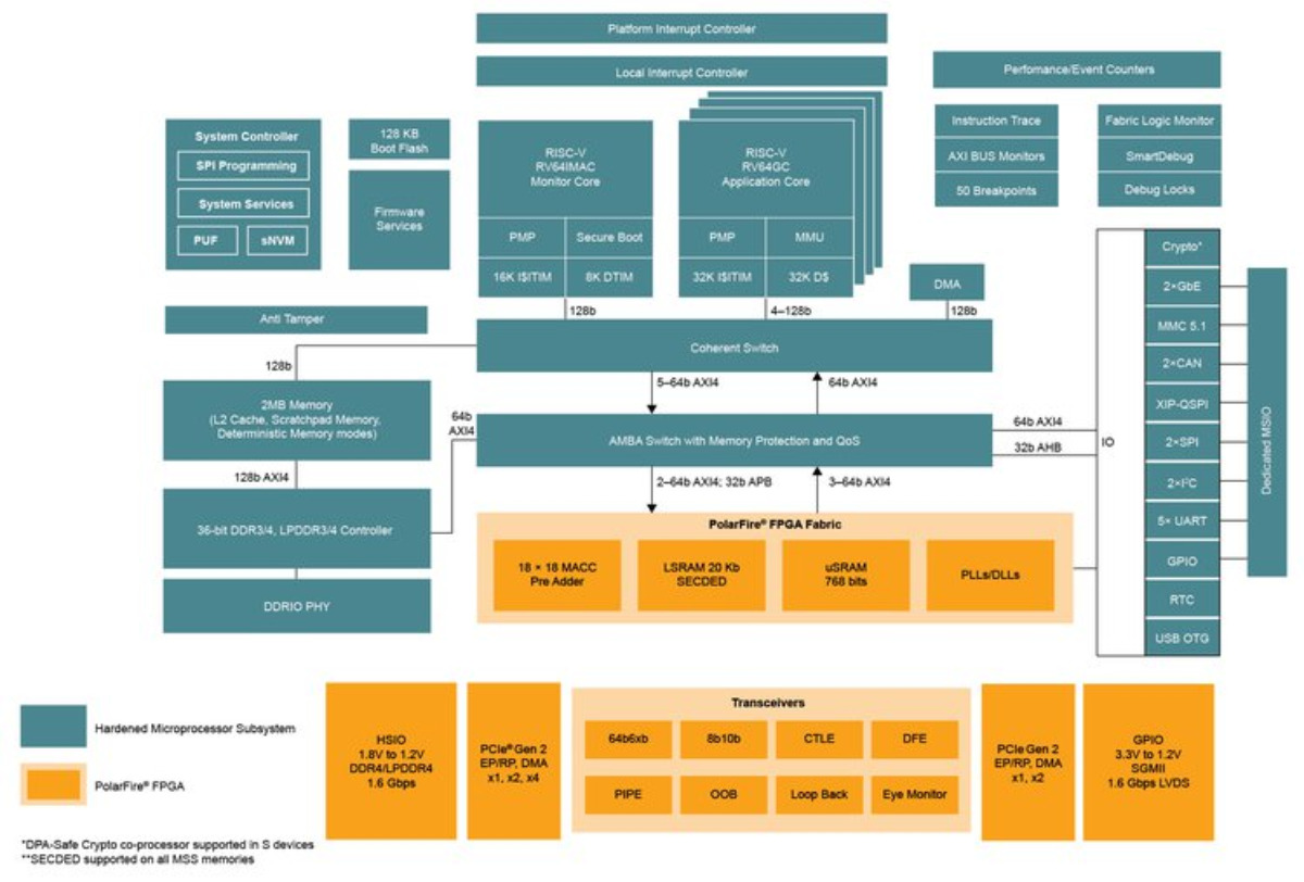

  PolarFire SoC Block Diagram
The Icicle tool is based on Microchip’s Polar SoC (MPFS250T-FCVG48EES), which is a system-on-chip that uses the effective PolarFire FPGA and a five-core RISC-V microprocessor subsystem together. According to the official PolarFire Soc document, the PolarFire® SoC FPGA family offers an unmatched combo of low power use, heat efficient, and defense-grade security for smart connected systems. This kit is the first system on chip (SoC) field-programmable gate array (FPGA) having an established, well organized RISC-V CPU cluster and a deterministic L2 memory subsystem which is compatible with Linux and real-time apps. PolarFire SoC device offers up to 50% lower energy than alt FPGAs, ranging from 25K to 460K  logic elements (LEs) featuring transceivers.
