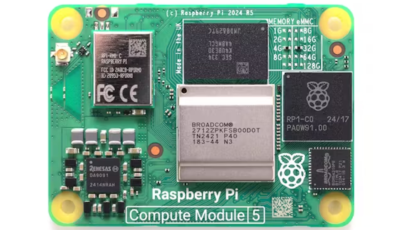

The Raspberry Pi Compute Module 5 (CM5) is a small board with the features of Raspberry Pi 5, making it useful for industrial and commercial projects. It features a powerful Broadcom BCM2712 quad-core 64-bit Arm Cortex-A76 processor running at 2.4GHz, options for up to 16GB LPDDR4 RAM with ECC, and eMMC flash storage ranging from 0GB (Lite) to 64GB.
The module supports dual 4Kp60 HDMI outputs, Gigabit Ethernet, and an optional wireless module with Wi-Fi 5 and Bluetooth 5.0 LE connectivity. It has additional ports like PCIe, USB 3.0, GPIO, UART, I2C, SPI, and camera/display connections, making it easier to create custom projects. Designed for reliability with an operating temperature range of -20°C to +85°C and a production lifetime until at least January 2036, it is suitable for applications such as industrial automation, IoT devices, robotics, and smart home solutions.
Previously, Raspberry Pi introduced the Compute Module 4 (CM4), which offers up to 8GB RAM and a Broadcom BCM2711 SoC with 4x 1.5GHz Cortex-A72 cores. Both have the same form factor, but the Raspberry Pi CM5 significantly boosts performance.

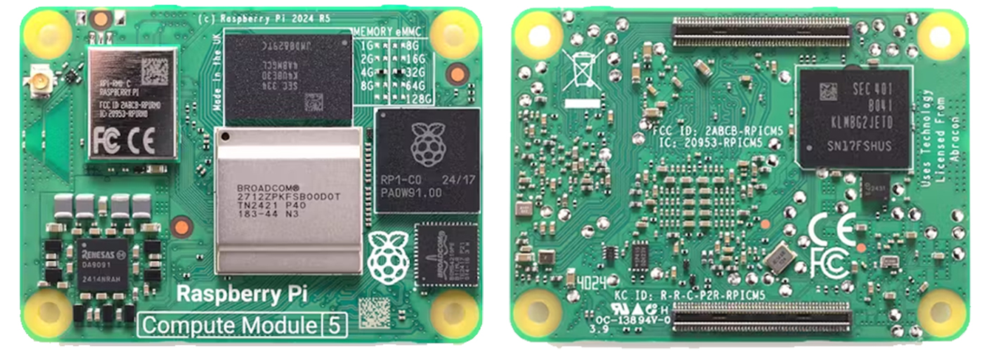

Raspberry Pi CM5 Front and Back
Raspberry Pi Compute Module 5 (CM5) Specifications:
  • SoC: Broadcom BCM2712
    • CPU:quad-core 64-bit Arm Cortex-A76 (Armv8) @ 2.4GHz
    • GPU: VideoCore VII GPU with OpenGL ES 3.1, Vulkan 1.2 support
    • VPU: 4Kp60 HEVC decoder
  • Memory Options: 2GB, 4GB, or 8GB LPDDR4-4267 SDRAM with ECC
  • Storage: 0GB (Lite), 16GB, 32GB, or 64GB eMMC flash
  • Video Output:
    • 2x HDMI 2.0 (up to 4Kp60 on both ports)
    • 2x 4-lane MIPI ports (DSI and CSI-2 for display/camera)
  • Networking:
    • Gigabit Ethernet PHY (supports IEEE 1588)
    • Optional wireless module with:
      • 2.4 GHz / 5.0 GHz Wi-Fi (802.11 b/g/n/ac)
      • Bluetooth 5.0, BLE
      • Selectable PCB trace or external antenna
  • USB:
    • 1x USB 2.0 port (high-speed)
    • 2x USB 3.0 ports (5Gbps simultaneous operation)
  • Expansion: 1x PCIe Gen 2 (5Gbps)
  • I/O Interfaces:
    • Up to 30x GPIO (1.8V or 3.3V)
    • Up to 5x UART
    • Up to 5x I2C
    • Up to 5x SPI
    • 1x SDIO interface
    • 1x DPI (parallel RGB display)
    • 1x I2S
    • Up to 4x PWM
    • Up to 3x GPCLK
  • Misc:
    • 1x SDIO 2.0 Storage ( for CM5 Lite only)
    • Optional 56 x 41 x 12.7 mm Raspberry Pi CM5 cooler (heatsink)
  • Power: Single +5V PSU input with USB PD (up to 5A @ 5V)
  • Physical Dimensions: 55 mm × 40 mm × 4.7 mm, 4x M2.5 mounting holes
  • Operating Temperature: -20°C to +85°C
  • MTBF Ground Benign: 143 000 hours (168 000 hours CM5 Lite)
  • Compliance: Various regional certifications (details on pip.raspberrypi.com)
  • Production Lifetime: Available until at least January 2036
In terms of software, the Raspberry Pi CM5 and CM5 Lite use the same software as the Raspberry Pi 5. While the official Raspberry Pi OS is recommended, other operating systems can also be used.

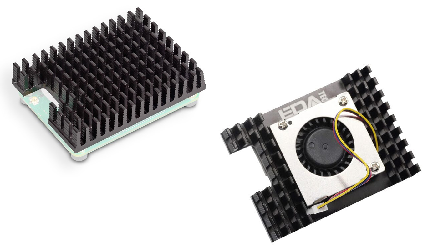

cooler for the CM5 and EDATEC CM5 active cooler with an opening for WiFi and Bluetooth antenna
Additionally, the new module has several parts that can get quite hot, but Raspberry Pi only includes a heatsink for cooling. EDATEC has made an active cooler for the CM5, which will be available on Digikey and Mouser.

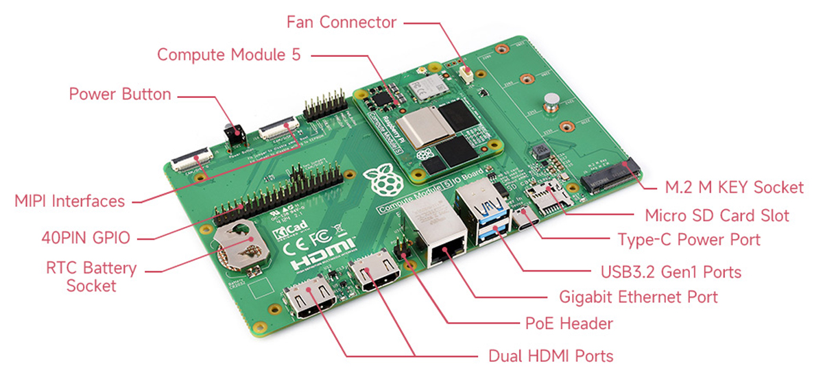

The company also mentioned that, like earlier Compute Modules, the Raspberry Pi CM5 has an IO board that helps test the module and develop software before making a custom carrier board. It was designed using KiCAD and will be open-source hardware.
Raspberry Pi CM5
Raspberry Pi Compute Module 5 IO board
IO board specifications:
  • Compatibility: Supports Raspberry Pi CM5 and CM5 Lite modules
  • Storage:
    • MicroSD card slot for CM5 Lite modules
    • M.2 M-key PCI socket for 2230, 2242, 2260, or 2280 NVMe SSD
  • Video Output: 2x full-size HDMI 2.1 ports (up to 4Kp60)
  • Networking: Gigabit Ethernet RJ45 with PoE+ HAT+ support
  • USB: 2x USB 3.0 ports
  • IO Expansion:
    • 40-pin GPIO header
    • Mounting holes for Raspberry Pi HAT+ connector
  • Miscellaneous:
    • Power button for waking and shutting down CM5
    • 4-pin PWM fan header
    • RTC battery socket
  • Power Supply: +5V/5A via USB-C PSU
  • Dimensions: 160 x 90 mm
  • Reliability: MTBF (Ground Benign): 131,000 hours
  • Production Lifetime: Available until at least January 2028
It is like a bigger version of the Raspberry Pi 5 with full-size HDMI ports and extra built-in features, but no USB 2.0 ports. The company also offers a full development kit with all the accessories including the IO Case.

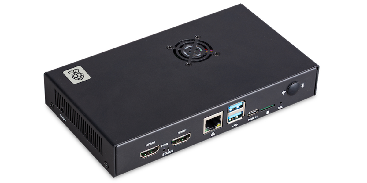

Raspberry Pi Compute Module 5 IO Case
The Raspberry Pi Compute Module 5 is available in various configurations, with prices starting from $45 to $135 due to the extra 16GB RAM option. The IO board is priced at $20, the IO case costs $15, and the cooler is available for $5 through the registered distributors. You can check its product page for more information about the Raspberry Pi Compute Module 5.
