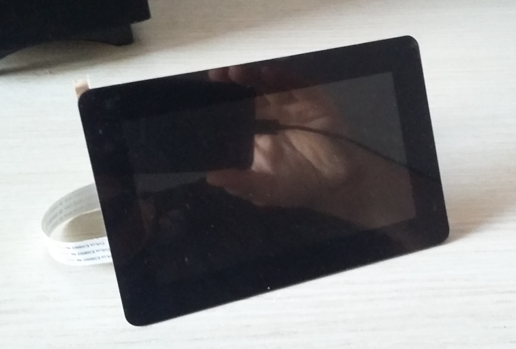

The LCD
The particular model we are going to test is an RVT43ULFNWC0x, which is a 4.3” TFT LED backlight display with FTDI FT801 controller and a resolution of 480×272 pixels (16:9). The display also has a capacitance touchscreen interface and can be easily controlled using SPI/I2C buses. The backlight is using 10 LEDs and has an output of 500 cd/m2 and color depth is 262k. The LCD display is powered from a 3.3V source and typical current consumption at 100% backlight brightness is 330mA. Operating temperature is wide and in the range of -20C to 70C.
Design of RVT43ULFNWC0x appears to be ideal for installation of all types of enclosures and using adhesive tape this can be done without any screws. External dimensions are 120.38×79.20mm with 8.43mm of maximum height.

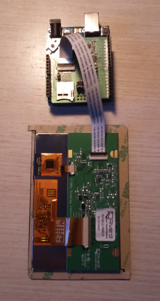

The Controller
2
FTDI FT801 controller manages all aspects of communication between your MCU and LCD display using SPI or I2C interfaces. It is also able to play 8-bit PCM files and μ-Law format with sampling rates of 8kHz to 48kHz.
On the back of the LCD we can easily see the LCD controller IC and touchscreen controller IC. Also there is a FFC connector with a pitch of 0.5mm to connect the LCD to your host board or Arduino Shield.
By default the LCD display works with SPI because as PIC 9 is internally pulled to ground. If you want to use I2C you should pull PIN9 to power. Keep in mind that only SPI mode 0 is supported and up to 30Mhz. The I2C interface operates up to 3.4MHz, supporting standard-mode, fast-mode, fast-mode plus and high-speed mode.
Backlight enable signal is internally connected to FT801 Backlight control pin. This pin is controlled by two FT801’s registers. One of them specifies the PWM output frequency, second one specifies the duty cycle.

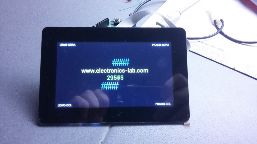

The first program we will run is written by www.jarzebski.pl and is able to display our Website URL along with a counter and a character passing over the screen. The code can be downloaded here.
The result is shown on the photo below:
