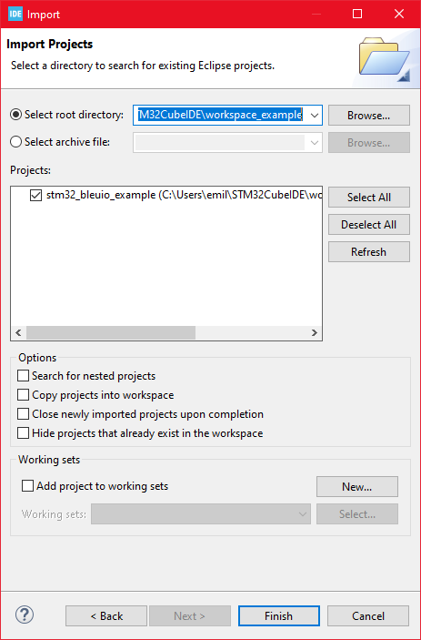

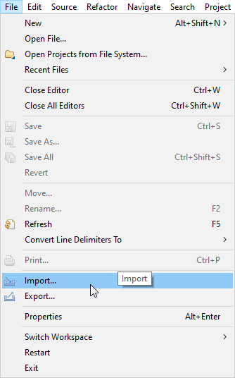

Part 2 : Importing as an Existing Project
From STM32CubeIDE choose File>Import…
Then choose General>Existing Projects into Workspace then click ‘Next >’
Make sure you’ve chosen your workspace in ‘Select root directory:’
You should see the project “stm32_bleuio_SHT85_example”, check it, and click ‘Finish’.
If you download the project as a zip file you will need to rename the project folder from ‘stm32_bleuio_SHT85_example-master’ to ‘stm32_bleuio_SHT85_example’

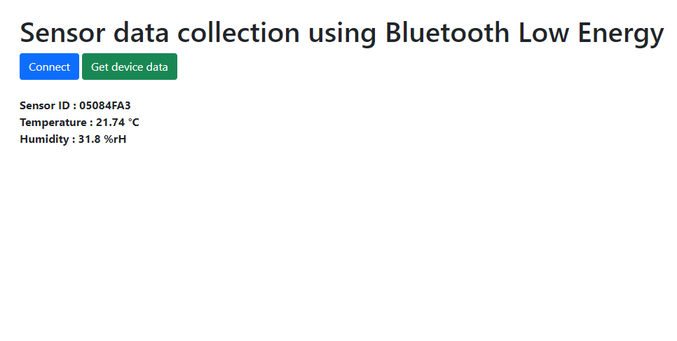

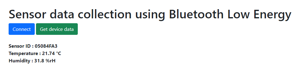

document.getElementById('response').innerHTML = `Sensor ID : 05084FA3 <br/>
Temperature : ${temp} °C<br/>
Humidity : ${hum} %rH<br/>`
The script js file has two button actions; connect and read advertised data.
We also need to update the Sensor ID on line 13 of script js. The Sensor ID of this example project is 05084FA3, which we got from SHT85.
Therefore this script looks for advertised data that contains sensor ID 05084FA3. After getting advertised data , we split the temperature and humidity information and show it on our index.html page.

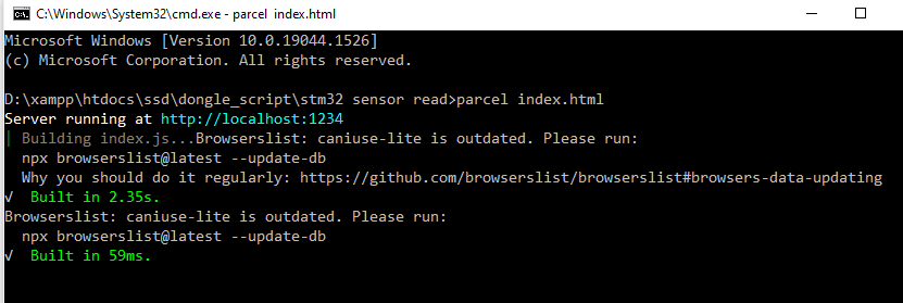

Now we need a web bundler. We can use parcel.js
Once parcel js is installed, let’s go to the root directory and type “parcel index.html”. This will start our development environment.
Let’s open the script on a browser and select the right port where the dongle is connected.
The web script is available on the web script folder of the GitHub repository.
