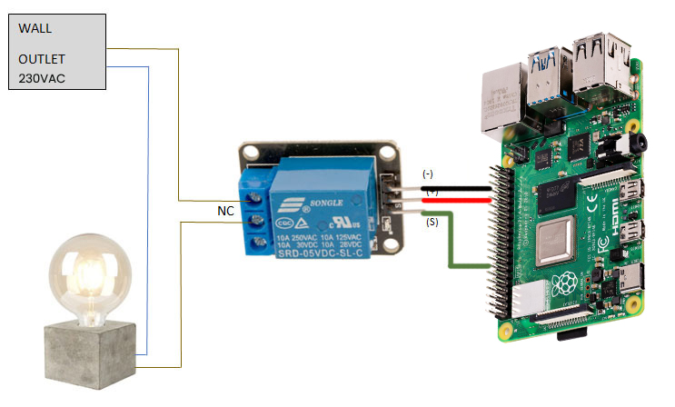

Connecting the relay
Always be very careful when experimenting with AC, electrical shock can result in serious injuries! NOTICE OF RISK; DISCLAIMER OF LIABILITY

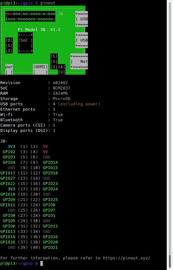

  • Edit the variable ‘switch’ in the script to the GPIO pin you want to use. (You can use the command pinout to get a graphical view showing you the GPIO pins for the board)

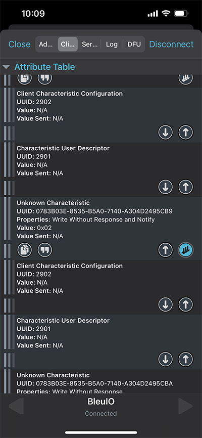

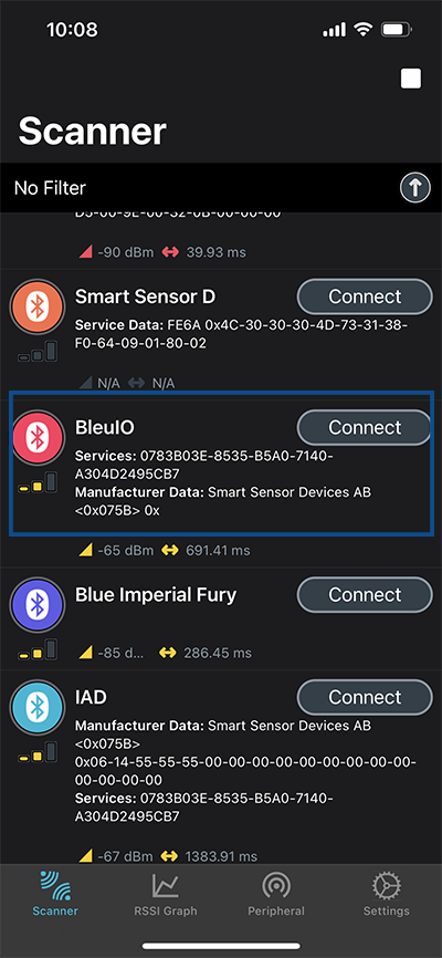

Instructions for connecting to the BleuIO to mobile
  • Download a BLE scanning App that can connect and read/write to a device. (Like nRFConnect or BLEScanner) AndroidIOS
  • Look for the dongle, it will be advertising as ‘BleuIO’.
  • Connect to the BleuIO Dongle.
  • To enable BleuIO to recieve commands you must first write 0x01 to the Flow Control characteristic (UUID: 0783b03e-8535-b5a0-7140-a304d2495cb9)
  • Now you can write to the Server RX Data characteristic (UUID: 0783b03e-8535-b5a0-7140-a304d2495cba) to control the GPIO.“SW=1”  for  ON
    “SW=0” for OFF

We have tested the script using nRFConnect app from both IOS and Android phones to turn on/off the light bulb. Here is the output of this project.
