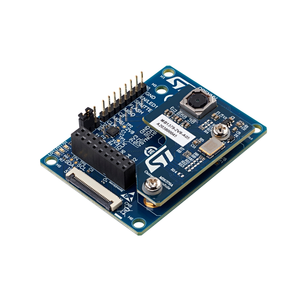

  • Sample implementations are available for the STM32H747I-DISCO Discovery board connected to the B-CAMS-OMV camera module bundle
B-CAMS-OMV
The B-CAMS-OMV camera bundle is compatible with FP-AI-VISION1 firmware. It provides the hardware with optimized training and deployment features. The bundle also comes with ST’s MB1379 5-Mpixel OV5640 color camera module fitted to an adapter card. It can work with all STM32 Discovery and Evaluation boards with a ZIF connector. The software support of Waveshare and OpenMV connectors allows the users to connect multiple third-party infrared and visible-spectrum cameras to address a wider range of computer-vision applications
